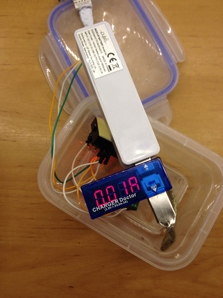

RE: RX circuit battery life - chokapick - 17-01-2015
What I use is this:
http://www.ebay.co.uk/sch/i.html?_from=R40&_trksid=p2050601.m570.l1313.TR10.TRC0.A0.H0.Xcharger+doctor&_nkw=charger+doctor&_sacat=0
But as you can see in the attached picture this model doesn't have enough resolution for this propose.
