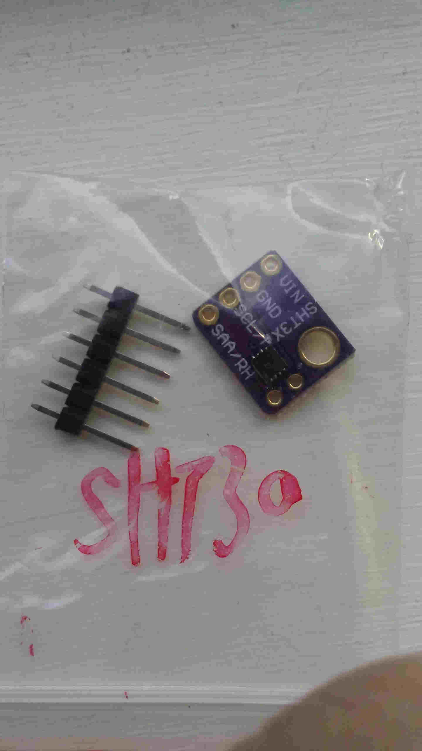

I believe you are correct. Here is a photo of it.
I suspect that this board can not be used on an I2C bus the same way an SHT-31-D would be used? it would need some sort of software to read the output?
RE: SHT-31 order experience - engolling - 17-02-2019
Have you tried it out to read it via I2C, my sensor, supplied by a Chinese supplier look identically.
I would just give it a try and see what happens.

RE: SHT-31 order experience - werk_ag - 18-02-2019
Hi Gord,
If it is the analogue version, there is no use for it with the WeatherDuino, but you can use it for other personal project. There is an official Sensirion Arduino library which can be used with the analogue versions of the SHT3x sensors. They require two analogue (ADC) ports.
Possibly the poor precision of the Arduino ADC, will make the readings not so precise as the sensor specs.
RE: SHT-31 order experience - AllyCat - 18-02-2019
(17-02-2019, 19:31)engolling Wrote:  Have you tried it out to read it via I2C, my sensor, supplied by a Chinese supplier look identically.
Yes, just fit the "SHT30" into either a Transmitter or Receiver board and load the Arduino : File > Sketchbook > Utilities > I2C_scanner  software (and the terminal emulator).  If it returns a valid address then it should be fine (with just slightly lower absolute accuracy than a SHT31).
However, if it really is an "analogue" version, then it might be quite "valuable".  Most Davis weather stations still use an Analogue version (which can fail quite often) and a replacement can be difficult to find and/or expensive!

RE: SHT-31 order experience - uncle_bob - 18-02-2019
That looks identical to the cheap SHT31s I brought from fleabay, which are working fine (for the moment Angel  )
