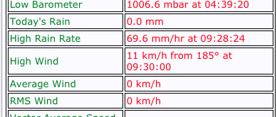

I have an issue with rain data using Weewx that I think is related to WeatheDuino. I have no daily rainfall showing, but rain rate etc is ok. Below is the raw data going into Weewx from WDuino. Note that 'rain' is "None" in REC and 0.0 in LOOP but 'rainDaily' is showing the correct 0.14 CM (1.4mm as the display shows). This causes Weewx to show no rain. Is this a bug?
REC and LOOP data below
p.p1 {margin: 0.0px 0.0px 0.0px 0.0px; font: 14.0px Menlo; color: #000000} span.s1 {font-variant-ligatures: no-common-ligatures}
REC:    2018-11-21 11:20:00 NZDT (1542752400) altimeter: 1007.21729621, appTemp: 13.735595804, barometer: 1007.51820501, cloudbase: 877.948364659, consBatteryVoltage: None, dateTime: 1542752400, dewpoint: 8.11654067169, ET: 0.0, extraTemp1: 0.0, extraTemp2: 0.0, extraTemp3: 0.0, forecastRule: 193, heatindex: 15.1111111111, highRadiation: 154.0, highUV: 1.6, humidex: 15.5676220998, inDewpoint: 11.1337736133, inHumidity: 51.0, inTemp: 21.7222222222, interval: 5, leafTemp1: 0.0, leafTemp2: 0.0, leafWet1: 0.0, leafWet2: 0.0, maxSolarRad: 923.372973101, outHumidity: 63.0, outTemp: 15.1111111111, pressure: 1006.82485506, radiation: 154.0, rain: 0.0, rainRate: 0.0, rxCheckPercent: 0.0, soilMoist1: 0.0, soilMoist2: 0.0, soilMoist3: 0.0, soilMoist4: 0.0, soilTemp1: 0.0, soilTemp2: 0.0, soilTemp3: 0.0, soilTemp4: 0.0, txBatteryStatus: None, usUnits: 16, UV: 1.6, windchill: 15.1111111111, windDir: 180.0, windGust: 4.82804400003, windGustDir: 180.0, windrun: 4.72185548037, windSpeed: 4.82804400003
REC:    2018-11-21 11:00:00 NZDT (1542751200) altimeter: 1007.08468448, appTemp: 15.857469893, barometer: 1007.38274948, cloudbase: 979.341726061, consBatteryVoltage: None, dateTime: 1542751200, dewpoint: 8.9144921535, ET: 0.0, extraTemp1: 0.0, extraTemp2: 0.0, extraTemp3: 0.0, forecastRule: 193, heatindex: 16.7222222222, highRadiation: 830.0, highUV: 7.6, humidex: 17.5153992142, inDewpoint: 10.8864323289, inHumidity: 50.0, inTemp: 21.7777777778, interval: 5, leafTemp1: 0.0, leafTemp2: 0.0, leafWet1: 0.0, leafWet2: 0.0, maxSolarRad: 882.19272482, outHumidity: 60.0, outTemp: 16.7222222222, pressure: 1006.69231715, radiation: 830.0, rain: 0.0, rainRate: 0.0, rxCheckPercent: 0.0, soilMoist1: 0.0, soilMoist2: 0.0, soilMoist3: 0.0, soilMoist4: 0.0, soilTemp1: 0.0, soilTemp2: 0.0, soilTemp3: 0.0, soilTemp4: 0.0, txBatteryStatus: None, usUnits: 16, UV: 7.6, windchill: 16.7222222222, windDir: 180.0, windGust: 1.60934800001, windGustDir: 180.0, windrun: 3.24661648034, windSpeed: 3.21869600002
REC:    2018-11-21 11:05:00 NZDT (1542751500) altimeter: 1007.01689624, appTemp: 15.6576933814, barometer: 1007.31502172, cloudbase: 1009.49569545, consBatteryVoltage: None, dateTime: 1542751500, dewpoint: 8.56155070726, ET: 0.0, extraTemp1: 0.0, extraTemp2: 0.0, extraTemp3: 0.0, forecastRule: 193, heatindex: 16.6111111111, highRadiation: 893.0, highUV: 8.2, humidex: 17.2533486221, inDewpoint: 10.8864323289, inHumidity: 50.0, inTemp: 21.7777777778, interval: 5, leafTemp1: 0.0, leafTemp2: 0.0, leafWet1: 0.0, leafWet2: 0.0, maxSolarRad: 893.075388458, outHumidity: 59.0, outTemp: 16.6111111111, pressure: 1006.62456665, radiation: 732.0, rain: 0.0, rainRate: 0.0, rxCheckPercent: 0.0, soilMoist1: 0.0, soilMoist2: 0.0, soilMoist3: 0.0, soilMoist4: 0.0, soilTemp1: 0.0, soilTemp2: 0.0, soilTemp3: 0.0, soilTemp4: 0.0, txBatteryStatus: None, usUnits: 16, UV: 6.8, windchill: 16.6111111111, windDir: 202.5, windGust: 1.60934800001, windGustDir: 202.5, windrun: 3.51484181368, windSpeed: 3.21869600002
REC:    2018-11-21 11:10:00 NZDT (1542751800) altimeter: 1007.04938012, appTemp: 15.1030467139, barometer: 1007.3488856, cloudbase: 974.741913508, consBatteryVoltage: None, dateTime: 1542751800, dewpoint: 8.34027085271, ET: 0.0, extraTemp1: 0.0, extraTemp2: 0.0, extraTemp3: 0.0, forecastRule: 193, heatindex: 16.1111111111, highRadiation: 614.0, highUV: 5.7, humidex: 16.6603637089, inDewpoint: 10.5826853911, inHumidity: 49.0, inTemp: 21.7777777778, interval: 5, leafTemp1: 0.0, leafTemp2: 0.0, leafWet1: 0.0, leafWet2: 0.0, maxSolarRad: 903.570090427, outHumidity: 60.0, outTemp: 16.1111111111, pressure: 1006.65703245, radiation: 180.0, rain: 0.0, rainRate: 0.0, rxCheckPercent: 0.0, soilMoist1: 0.0, soilMoist2: 0.0, soilMoist3: 0.0, soilMoist4: 0.0, soilTemp1: 0.0, soilTemp2: 0.0, soilTemp3: 0.0, soilTemp4: 0.0, txBatteryStatus: None, usUnits: 16, UV: 2.0, windchill: 16.1111111111, windDir: 202.5, windGust: 8.04674000005, windGustDir: 202.5, windrun: 3.78306714702, windSpeed: 3.21869600002
LOOP:   2018-11-21 11:25:00 NZDT (1542752700) altimeter: 1007.14960751, appTemp: 13.6276579882, barometer: 1007.45047725, cloudbase: 879.082760881, consBatteryVoltage: 0.0, dateTime: 1542752700, dayET: 0.0, dayRain: 0.140000000035, dewpoint: 8.27410964992, extraAlarm1: 0, extraAlarm2: 0, extraAlarm3: 0, extraAlarm4: 0, extraAlarm5: 0, extraAlarm6: 0, extraAlarm7: 0, extraAlarm8: 0, extraHumid7: 49.0, extraTemp1: 0.0, extraTemp2: 0.0, extraTemp3: 0.0, extraTemp4: 0.0, extraTemp5: 0.0, extraTemp6: 0.0, extraTemp7: 20.0, forecastIcon: 0, forecastRule: 0, heatindex: 15.2777777778, humidex: 15.7994723419, inDewpoint: 10.8864323289, inHumidity: 50.0, insideAlarm: 0, inTemp: 21.7777777778, leafTemp1: 0.0, leafTemp2: 0.0, leafTemp3: 0.0, leafTemp4: 0.0, leafWet1: 0.0, leafWet2: 0.0, leafWet3: 0.0, leafWet4: 0.0, maxSolarRad: 932.670264148, monthET: 0.0, monthRain: 0.0, outHumidity: 63.0, outsideAlarm1: 0, outsideAlarm2: 0, outTemp: 15.2777777778, pressure: 1006.75720404, radiation: 166.0, rain: None, rainAlarm: 0, rainRate: 0.0, soilLeafAlarm1: 0, soilLeafAlarm2: 0, soilLeafAlarm3: 0, soilLeafAlarm4: 0, soilMoist1: 0.0, soilMoist2: 0.0, soilMoist3: 0.0, soilMoist4: 0.0, soilTemp1: 0.0, soilTemp2: 0.0, soilTemp3: 0.0, soilTemp4: 0.0, stormRain: 0.0, stormStart: 943873200, sunrise: 1542711600, sunset: 1542711600, trendIcon: -1, txBatteryStatus: 1, usUnits: 16, UV: 1.8, windchill: 15.2777777778, windDir: 200.0, windGust: 6.43739200004, windGustDir: 200.0, windSpeed: 6.43739200004, windSpeed10: 4.82804400003, yearET: 0.0, yearRain: 1.2200000003

I perhaps should have explained my testing process so far. I have done exactly as you suggested already.  The data I posted above is the raw data as coming from WeatherDuino to Weewx. I am manually tipping the bucket to create rain and Weewx shows the rain amount in dayRain (used as part of the live data via MQTT) and the rain rate is recorded (see below) but not the actual rain amount. Yes I have the correct collector types etc.
I'll collect more data while I create rain and post that here.

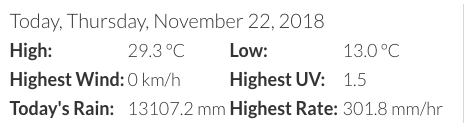

RE: A rain bug in Vantage data? - 41south - 22-11-2018
Too many strange things happening .....
It starts to work briefly after turning off debug, now it stops again
I will await your tests with thanks
Huh
Update - I need an Ark!!  Tongue Tongue
Ah, interesting to know about that the data, many thanks agin for explaining.
In the end I *think* what bought the rain to life was re-enabling the hardware processing within Weewx, I don't know enough about the way the Davis protocol and Weewx work to even begin to explain the reason - it works and that is good enough for me  Smile
