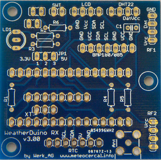

OK just getting my RX board ready and the pins on the board for the DHT22 are not all labelled. Right two are labelled Dat (Data?) and Ucc (NC) so which of the left pins is VCC and which is GND?
RE: DHT22 Temperature/Humidity Module - werk_ag - 25-11-2014
I believe your RX board is a v3.00.
I know letters are very small, but there is no Ucc.
DHT22 ----- Board
VCC -------- Vcc
DATA ------- Dat
GND -------- Any of the no labeled pins
WeatherDuino Pro2 RX board v3.00
[Image: WDPro2_RXv300.jpg]
