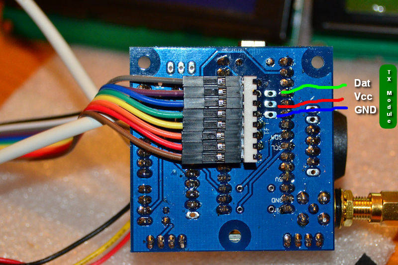

Data relay feature
All previously released RX boards already have on the underside of the board, connector pins for an additional TX module. This module can be one exactly equal to the one used on the TX boards (see TX v2.50 parts list), or a STX822 like this (very powerfull at only 5V):
[Image: mJc8SImu9pVLy3ttZ1E9_Rg.jpg]
Bellow is an ilustration on how to connect a 433Mhz TX module to the existing pins.
[Image: WDPro2_TXrelay_connector.jpg]
And it's done!
