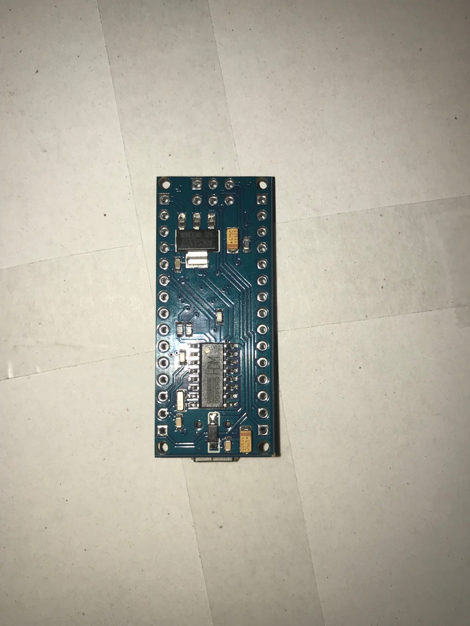

I'm getting to the point where I feel that I need to rule out the Nano as being the problem and recall reading that a diode would need to be removed from it to stop it from being powered over USB. However the photos I've seen of other Nano's here have a very slightly different component layout.
I've attached a photo of the underside of my spare Nano (the side which has the CH340G controller) and I'd be grateful if someone might be able to confirm which component it is I should be removing - I think it's the component that sits between the USB port and the end of the CH340 controller.

(31-12-2017, 21:28)cjthomson Wrote:  ... I think it's the component that sits between the USB port and the end of the CH340 controller.
Yes, its that component (black with white trace in one of the sides).

Well, that is new info, which indeed configures an issue that seems related with the diode on the Nano. Some post above you tell me that your Pro2 RX board is a v6, unless some error occured during the assembling (as you know Pro2 RX v6.x boards are suplied fully assembled) the Arduino Nano installed on those boards already have the diode removed. That is the reason I started by discarding a problem with the diode.
Its easy to check if the diode was been removed or not. If the Nano becomes powered by just inserting the USB cable, then the diode is there.
