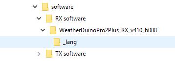

RE: Software upload issue - AllanG - 12-12-2017
Jim, you *have* got a subdirectory named _lang (and containing the language files) like this, haven't you??
This version works perfectly for me.
Allan

Allan,
I will check shortly, I was surprised to have an issue as the software is usually no problem.
Allan,
Yes I have found the correct file with a _lang sub directory and will try again tomorrow

Hi Werk, Allan,
What was the issue was that when I "saved as" my amended Config files with a distinctive name the _lang sub directory was not included; I copied it across and now uploaded fine
