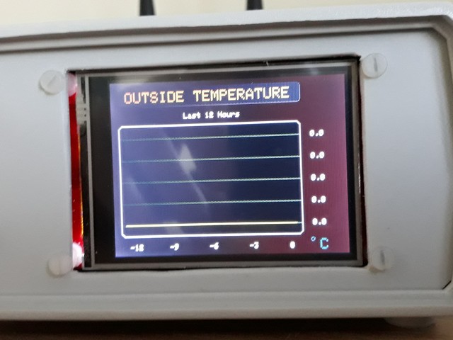

Hi
This morning my station recorded a temperature of -9 degC, but the trend display on the Pro2+ RX shows a flat line and the temperature scale all show 0.0.
Am I missing something in the settings?
RE: Pro2+ RX temp trend not displaying below zero - werk_ag - 11-12-2017
Thank you for your report. It can be a bug, I will check that as soon as possible.
Can you please tell me what software version are you using?

RE: Pro2+ RX temp trend not displaying below zero - rich27gc - 11-12-2017
(11-12-2017, 15:56)Werk_AG Wrote:  Hi,
Hi Werk
I'm using WEATHERDUINO PRO2 + v4.1 b006

Hi Allan
I'm supposing you are talking about the last 12h temperatures graph, right?
If yes, please read my anwser to Rich.

Hi Rich.
It's confirmed, there is a bug that its preventing showing temperatures below zero on the graph.
The bug it's already corrected. An updated software version will be published tonight.
Thank you for having reported it.
