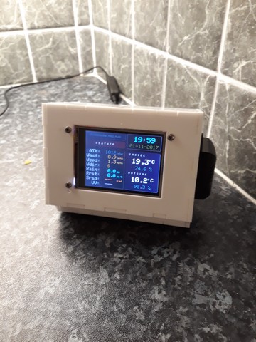

I've finished building the wireless display and I'm really pleased with it.
The construction was very easy only took a couple of hours to solder everything in place and program. I have just recently ordered and received the case for it, after searching the forum I found the case I wanted : -
https://www.ebay.co.uk/itm/Adafruit-PiTFT-2-8-034-LCD-TFT-case-enclosure-for-Arduino-Uno-Mega-/122759016490?
I'm really pleased with how it looks.
Recently on the forum was some talk about reception problems, I am happy to say that it works perfectly in my house with no antenna attached and both antenna on the RX unit are vertical.
Rich

RE: Wireless display - werk_ag - 02-11-2017
(01-11-2017, 21:10)rich27gc Wrote:  I've finished building the wireless display and I'm really pleased with it.
Hi Rich
Thank you for sharing your experience. I'm glad you are pleased with how it works, personally I'm a fan of the Wireless Display units.
Now, is like you have a second portable weather station.
