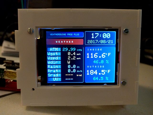

I uploaded the Wireless Display software today and the temperature reading is off. I think it's similar to the Pro2+ when it was displaying really high temp readings for Fahrenheit before the software fix.
A different issue, but my touch screen isn't working. I think it may be because the TFT display fits slightly too tight in the case it is in, or I have the wiring wrong.
TIA
ETA: I'm using the SHT35-D sensor that is set to 0x45 for the Wireless Display.
RE: Wireless Display Fahrenheit off - danner - 21-08-2017
I just noticed that the ATM reading is off too. The receiver is showing 30.02inHg and the WirelessDisplay is reading 29.99inHg.

RE: Wireless Display Fahrenheit off - danner - 22-08-2017
I removed the TFT display from the case and the touch screen still doesn't work so I assume I have the wires wrong.
I found the ATM multiplier in the Rx tab. It didn't appear to go enough decimal places so I changed it and now the ATM reading appears good.
I also kind of figured out how to make the inside, or the outside, temp sensor read correctly, but not both at the same time, LOL.
RE: Wireless Display Fahrenheit off - werk_ag - 23-08-2017
Keep in mind that the values on the main receiver aren't always immediately reflected on the WD units, Wind data is almost immediate but others may take some time to update.
RE: Wireless Display Fahrenheit off - danner - 23-08-2017
(23-08-2017, 03:14)Werk_AG Wrote:  Keep in mind that the values on the main receiver aren't always immediately reflected on the WD units, Wind data is almost immediate but others may take some time to update.
I watched the ATM on and off for a while and the pressure was always off by -0.03inHg. After I added more decimal places to the multiplier now the pressure on the WirelessDisplay tracks the Pro2+ receiver.

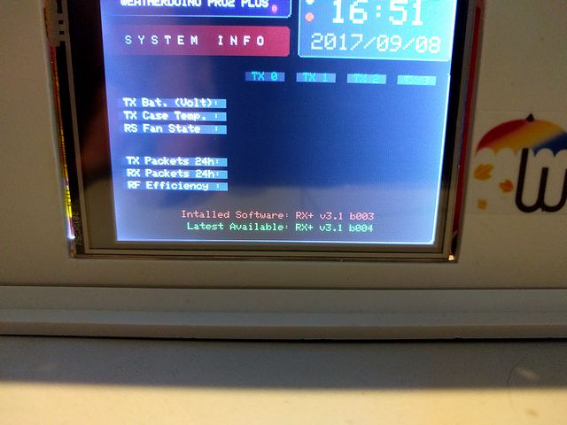

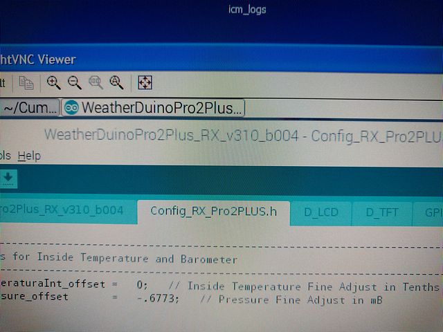

I just upgraded the receiver to the new software release v3.1 b004 but the system info screen insists I am still on b003. I also upgraded the WD unit to v3.0_b006 but its system info screen also insists I am using the previous version b005, and still isn't displaying the temps properly. I've recompiled and re-uploaded both a couple of times. Not sure what is going on.
RE: Wireless Display Fahrenheit off - danner - 08-09-2017
The top picture shows the software version I uploaded to the Receiver. The bottom picture show the software version AFTER uploading b004, but it says it is still using b003?
This is the WD sketch I uploaded.
