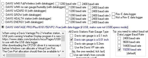

The test I implemented was run with open Weather Display and selecting Davis (attached image of the used setup) but I did not have any output from Arduino ... As soon as I have time, I will also try with cumulus to see if it is a configuration issue or something else ...
Can any help be available to understand the part about Davis emulation?
thanks a lot!
Federico

Weather Display works OK with Weatherduino, it is unlikely to be WD causing the problem.
Trial with Cumulus if all else fails.
