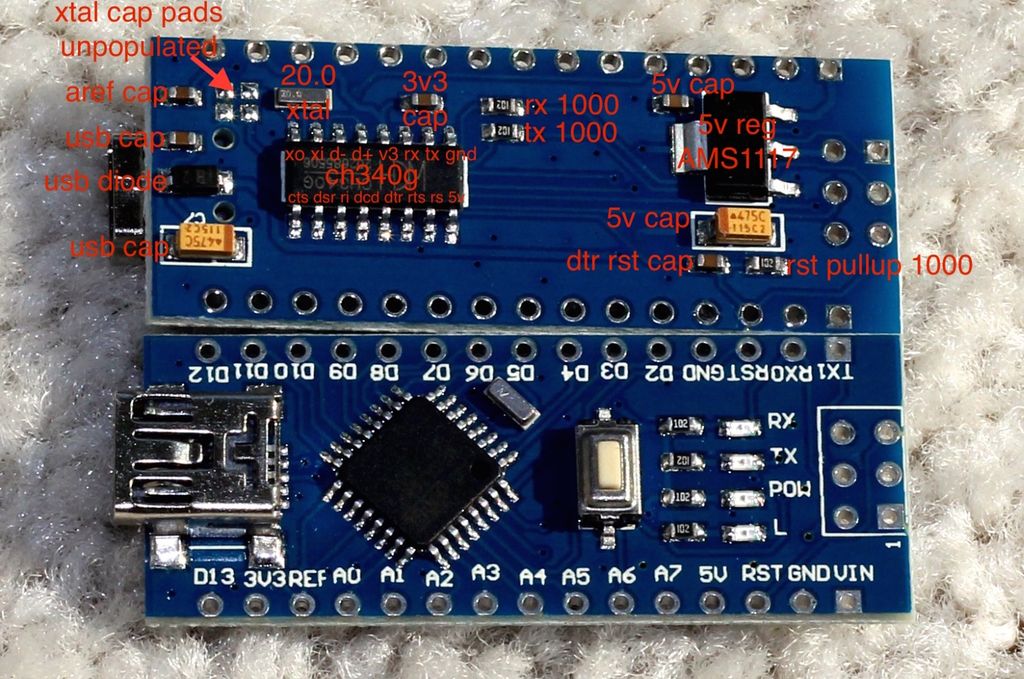

I've found this page which describes the 340G Nano PCB layout. I'll compare vs my nanos. I'm assuming the component marked "USB diode" is the one to remove.
http://www.instructables.com/id/Arduino-Nano-ATmega238PCH340G-v30-PCB-layout/
Image also attached here for posterity in case the link breaks.
RE: What modifications to Arduino nano? - werk_ag - 27-03-2017
Quote:I'm assuming the component marked "USB diode" is the one to remove.
That's right!
