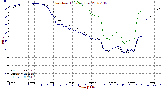

Having ±5% would be fine for this price class, but 10 - 30% is not. I believe that those cheap sensors are not meant to last outside for several months. I do have now a new Vantage Pro with SHT31 humidity sensor and that match quite closely to SHT11 readings, both are outside about 5 m apart. Will replace other sensors with SHT31 before winter time.

There were not so many other versions earlier, but now I can find quite many SHT31 variations. Hopefully the difference is only pcb, not the sensor itself. SHT11 has been outside one year now and it's giving the same readings as new SHT31, therefore I have some faith on Sensirion (for now)...
RE: HTU21D Temperature / Humidity sensor - Mikko - 21-06-2016
Here is the latest picture with fresh SHT31, Sensirion sensors match quite well.
[Image: humi20160621.png]
