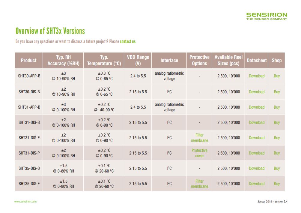

Hello, this sensor is very interesting - it is more accurate then SHT31 ...
Thank you for good hint...
