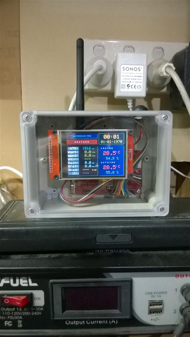

I went to reflash one of my older wireless displays. It has a 2.8" TFT screen, mounted in behind a transparent LID (photos on my old build thread). The screen is not accessable for "touch" operation. I have a push button mounted on the top of the enclosure.
[Image: attachment.php?aid=624]
