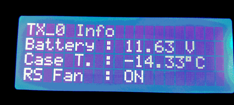

Hola he colocado la versión b012 en el Tx y la temperatura de la caja me da -14.33ºC, he colocado la version b010 y da una temperatura de 19,39ºC me puedes indicar que estoy haciendo mal.
Gracias.
[Image: attachment.php?aid=822]
[attachment=822]
Hi Ardummy,
Thank you for having reported about this. After checking, I found that the problem is caused by a bug in TX v2.00_b012 version.
It is already fixed. Please, download the latest release (20161126).

I have the same issue with the software reporting -48.71 Tx case temp and have just uploaded the latest Tx software included in the pro plus release but the problem persists.

(09-12-2016, 03:06)Barrow4491 Wrote: [ -> ]Hi,
The issue which caused erroneous case temperature readings, has said two topics above was fixed on TX software b013, and I'm sure about that.
Please check your user config settings, or attach them to a post and I will give a look to them.
If it was working before the upgrade, it should be working now too.

I have re compiled and uploaded b013 and the temperature displays as negative (refer attached image).
I have attached my config file

Can you please tell me what was the last TX software build where the case temp is correctly reported?
Have you tried to use the TX debug function?
(11-12-2016, 05:16)Werk_AG Wrote: [ -> ]Can you please tell me what was the last TX software build where the case temp is correctly reported?
Werk
Previous build that worked was b010. No I haven't tried the debug as I am unsure of how to do it.
