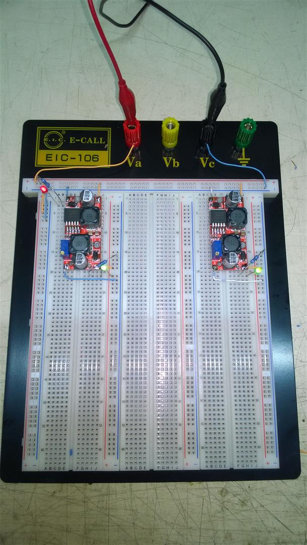

Just thought I'd post a couple of photos of a new bread-board that I've made up, for prototyping and experimenting. May give some ideas or inspiration to someone out there looking to 'tinker' and experiment. This particular board was purchased from Altronics in Aus, and cost around $37 on special. I've gone for this larger size with three integrated vertical boards, giving five buses for power distribution or whatever else you need and plenty of room to move. May seem large now, but I can assure you, it does get used up when your mind starts running with ideas.... Wink I also added a couple of buck/boost regulator modules, which can be found on eBay for about $3 or $4 each. This gives me a 12v rail across the top of the board, and then 5v and 9v power rails down the sides.

That's the way everything starts... watch out, the Arduino is a very addictive stuff. Smile

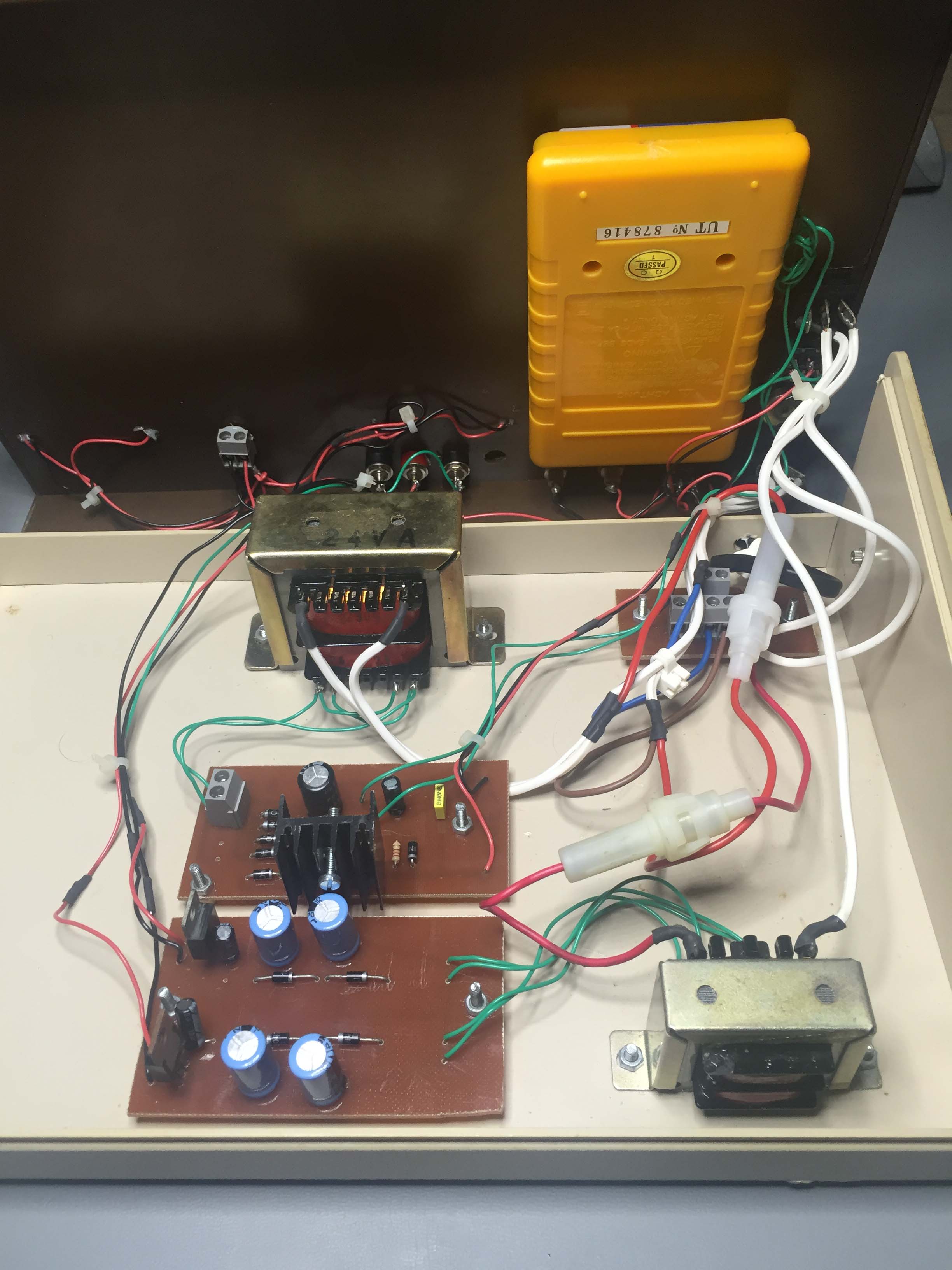

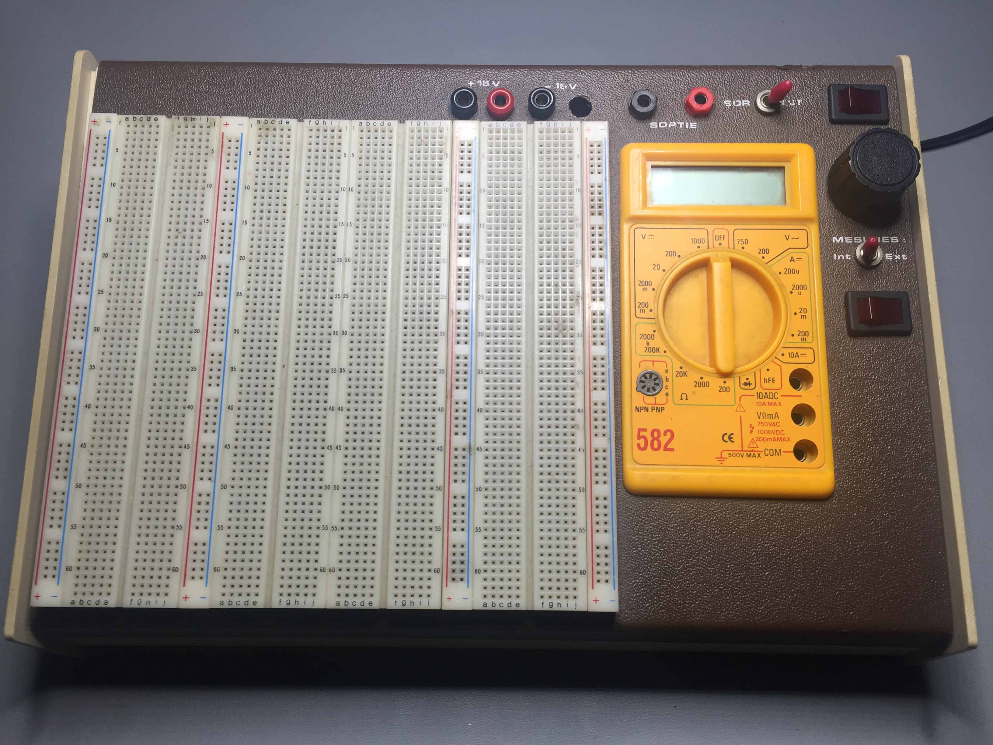

I share the one I use and that I build a long time ago..
It is build in a case where I have integrated a DMM and two power supplies: +/-15V fixed for op-amp power and a 0-30V/1A variable power supply that is connected underneath to the 4 bread-boards. It can also be used as an external power supply.

Very nice work!
Hey, that's a really nice setup zitoue. Seems it has stood the test of time... Nice...
