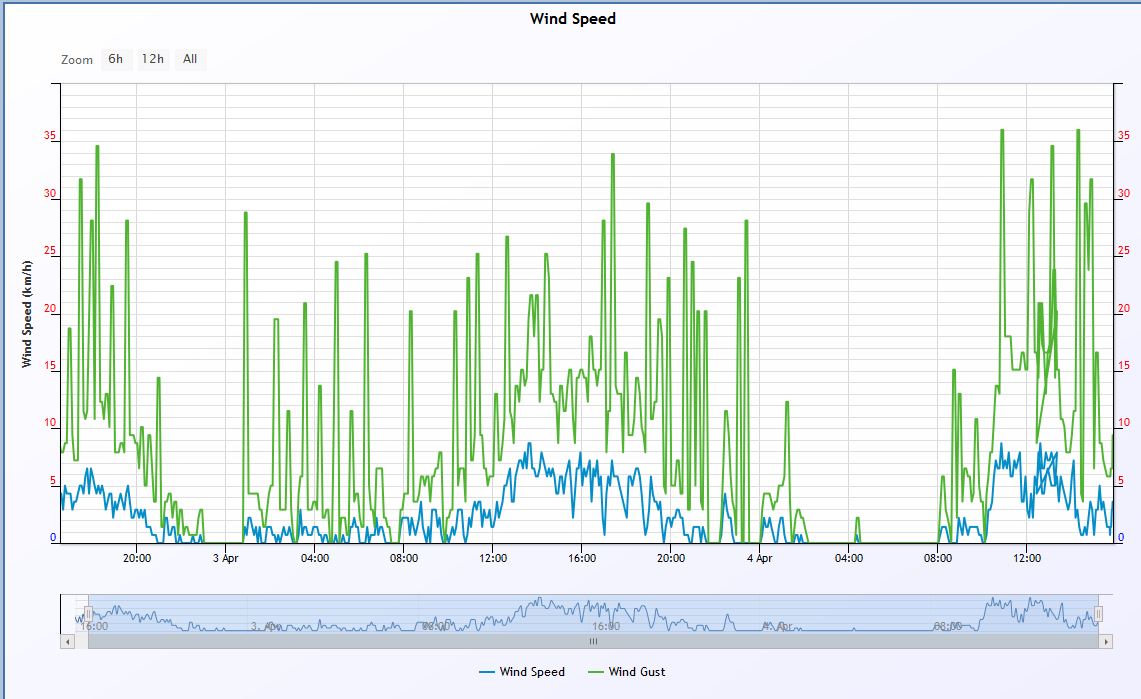

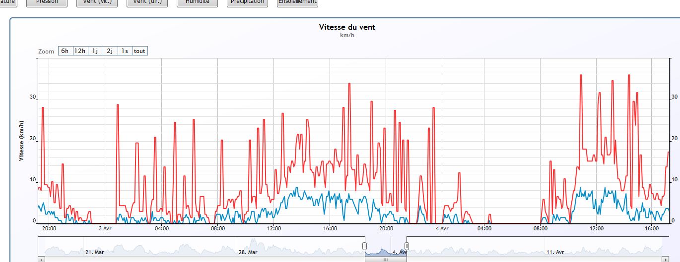

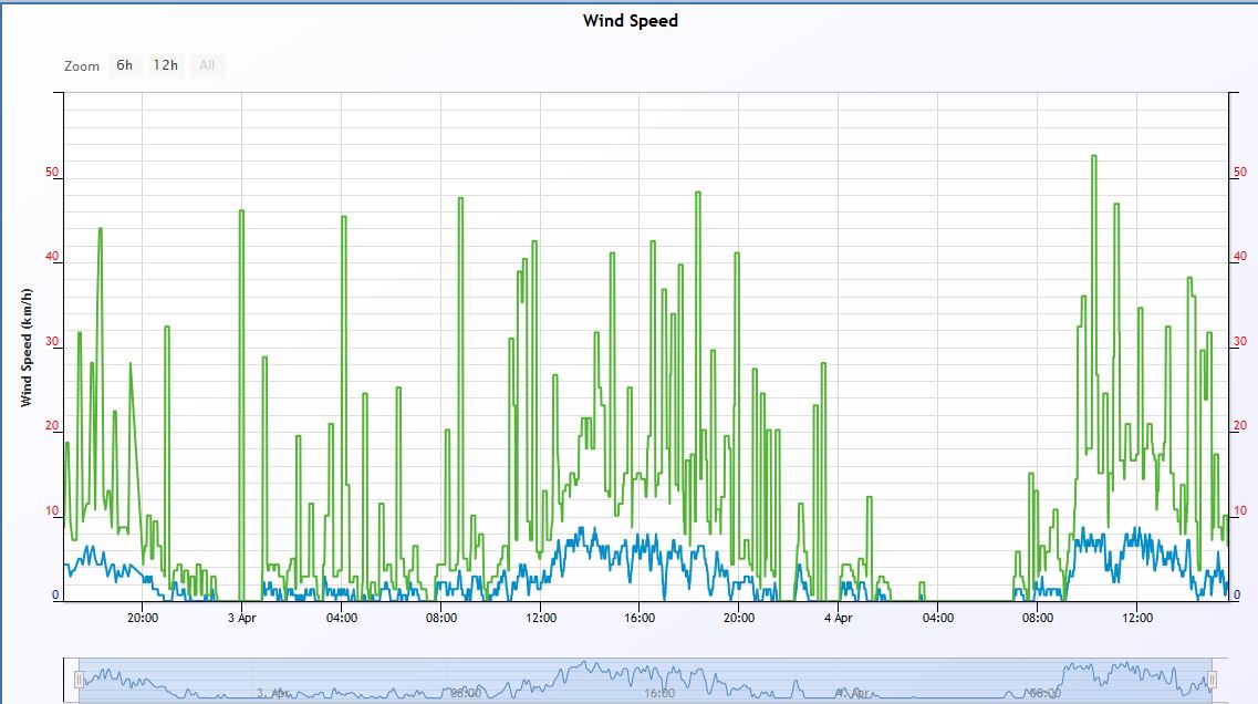

V2.0 spike control give me significative higher gust than V1.5.
WD 1.5 graph
[attachment=640]
WD 2.0 graph
[attachment=641]

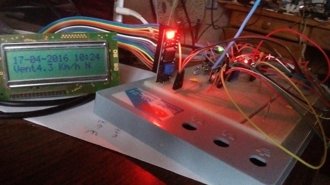

Indeed it's the same period, I managed to build a second RX on a breadboard connected to CMX.

(15-04-2016, 16:17)laulau Wrote: [ -> ]V2.0 spike control give me significative higher gust than V1.5.
Are you sure? The v1.5 graph shows gusts up around 50 km/h, whereas the v2.0 graph shows maximum values around 35 km/h.
Oups! I have inversed the graph names.
I'm sure here is the historic for the same period and i had V1.5 RX soft running.
V max ~35km/h so the V2 graph is the one with 50km/h gusts.
[attachment=642]
