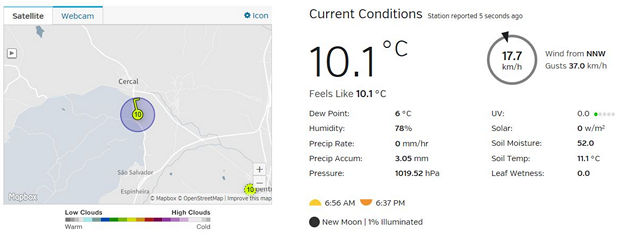

I'd like ask if you have someone sending data to the Weather Underground connected soil (moisture and temperature) sensors and if you manage to send this data to the WU web.
(I can see my friend Werk_AG has this problem maybe too, but I can see only Cumulus 1.9 web, not Cumulus MX ..., so I don't know.)
This is on my Cumulus MX web:
[Image: CU-upr.jpg]
But this is on the Weather Underground web:
[Image: WU-upr.jpg]
I think I have something wrong in the Cumulus configuration, so I should ask for it in the Cumulus forum, but I think someone here has already solved this problem probably ...?
Thanks for any advice.

(10-03-2016, 00:36)Werk_AG Wrote: [ -> ]To allow Cumulus to send soil and leaf data to WU, you need to do this:
Edit cumulus.ini (with Cumulus stopped) and add any of the following to the [Wunderground] section:
SendSoilTemp1=1
SendSoilMoisture1=1
You're right, as always, it works:
[Image: SoilSensors.jpg]
Thanks.
