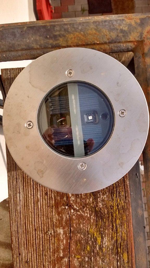

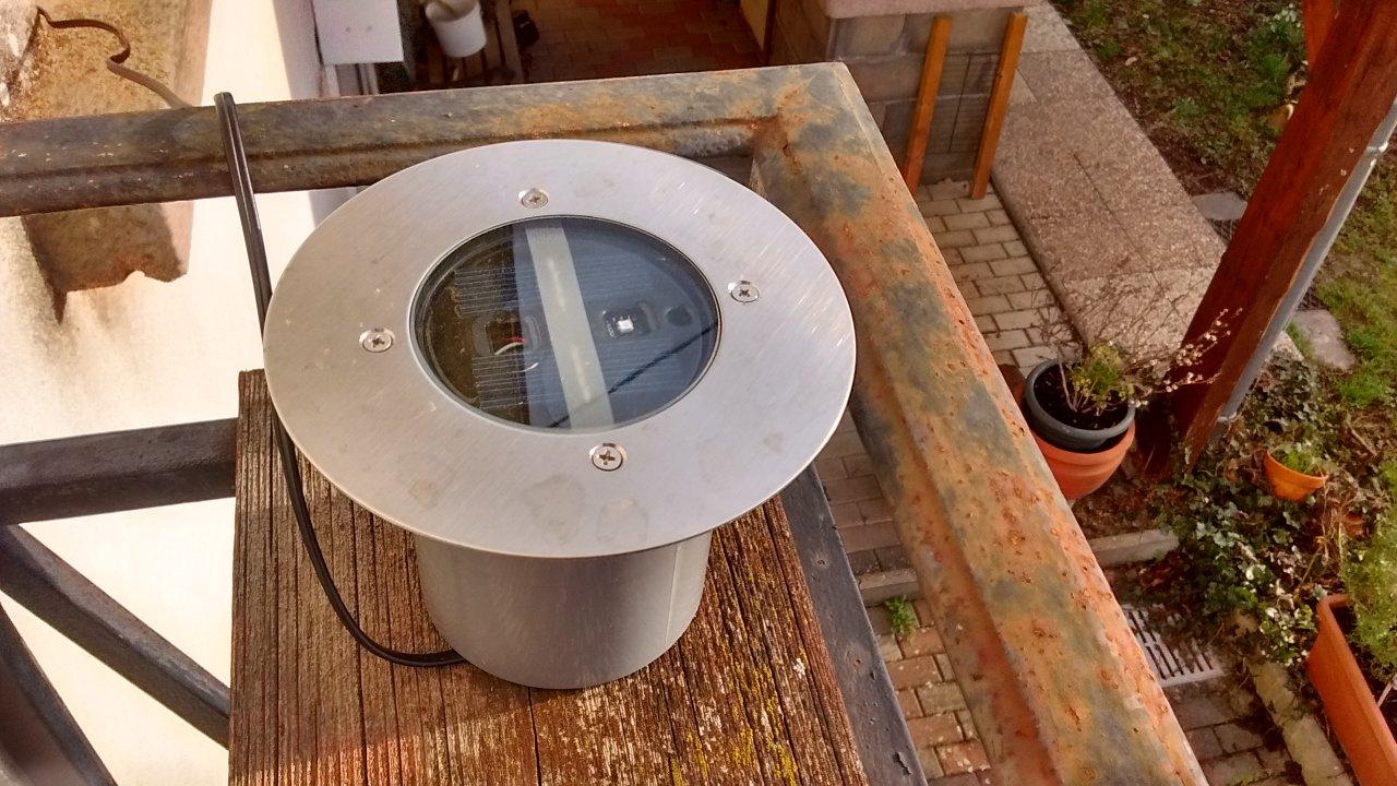

I have mine in a very similar enclosure.
I kept the original PV cell and put a proto PCB into the plastic box that was inside. I reused one hole for the UV sensor. I tried to align the inside PV cell connections with the white trace of the cover.
[attachment=567]
[attachment=568]
Calibration hasn't been done correctly because i have to wait for a clear summer day!
Some questions (@ Werk_AG):
Is it possible to have the dimensions of the PCB and the PV cell from your solar kit to see if i can swap them at some point.
Where did you find the cover without the white trace ?
Is the UV sensor sensible to this white trace ? if no it's perhaps better to align the trace with the UV sensor!
Laurent

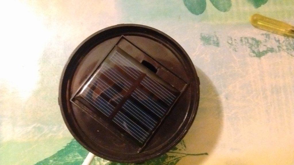

New enclosure for Werk_AG hardware i've bought recently.
No UV sensor for the moment.
I'm afraid that the glass cover reduce significantly the measurements!
I started to use the same type of enclosure a few months ago with the small center circle frosted. I found I needed to add a multiplier of 1.6 to the solar and 3.0 to the UV sensor to get accurate results with this sort of enclosure.
(21-05-2016, 01:16)Palmyweather Wrote: [ -> ]I started to use the same type of enclosure a few months ago with the small center circle frosted. I found I needed to add a multiplier of 1.6 to the solar and 3.0 to the UV sensor to get accurate results with this sort of enclosure.
For the solar sensor, you will get a better calibration slightly adjusting the variable resistor on the Solar / UV interface, than adding a multiplier in the formula.
Not so easy, but better.
