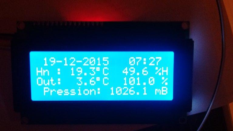

This morning outside humidity was showing 101.0%!!
Sensor is a SHT21.
[attachment=512]
shouldn't be a limitation to 100% somewhere ?
Yes, there should be! Or not... Smile
I'm wondering why the sensor is reading a value greater than 100%?
Implementing a limitation to 100% it's easy, but for now, I think is more important find why the sensor is given a reading like that.
Please report if it happens again. Do you have a picture of your SHT21 sensor? Cable length?
In next software release, I will implement a check to limit the display value to 100%

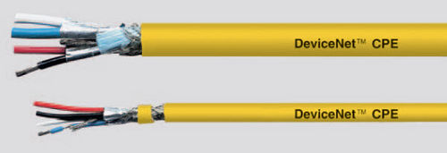

The cable is a ~9 meter 'Devicenet' cable like this : [attachment=514]
Shield isn't connected for the moment.
the cable will certainly be shorter on the final location.

If you need to use a long cable between the sensor and the TX unit, why you haven't chosen a SHT1X family sensor? The SHT2X family sensors use I2C protocol which was designed for communication with very short cables. Hope you have connected the sensor to LI2C port on the TX unit and not simply to the I2C connector. Even using the I2C bus expander chip installed on the TX unit, 9 meters is on the limit of the risk (ideally a second chip should be used at the end of the cable).
We already have talked about this in another topic:
http://www.meteocercal.info/forum/thread...ml#pid3058
As a general advice try to follow this rule: Do your best to use short cables between all the sensors and the TX unit.
Regarding I2C communications, a shielded cable doesn't solve everything, most of the times the problem is the capacitance of the cable which increases with the length.
This is very strange! I've just noticed that although Cumulus is only showing 100% outdoor humidity, the WeatherDuino RX display is showing 100.4% Sensor is SHT21 connected to the TX by 75cm of cat5 cable.
I've also noticed that instead of the display showing "In" it has "Hn" instead, just as laulau's display in the photo. Strange!!
** Just realised - I guess the H in "Hn" is caused by the extra digit in the humidity reading causing the text to wrap around...??

Although I also use an original SHT21, until laulau described this situation, I was unaware of the possibility of sensor reporting values greater than 100%.
In the coming days will be published a new version of RX and WD software, which in addition to several improvements, will prevent from being shown relative humidity values higher than 100%
