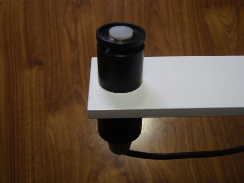

Didcot Instruments Weather Station. I have acquired some of the bits for this station See attached, Would it be reasonable to fit an Op Amp to the DRS-5 to get the signal up so that Weatherduino could read it. My knowledge of electronics is a bit limited.

Global Radiometer DRS-5
Net Radiometer DRN-301
Wet and dry PT100 thermometers DTS-5
DRS-5:

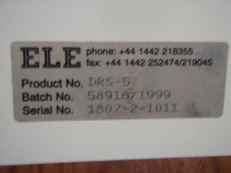

Silicon pV cell below polycarbonate diffuser, cosine corrected (see calibration Certificate) attached;

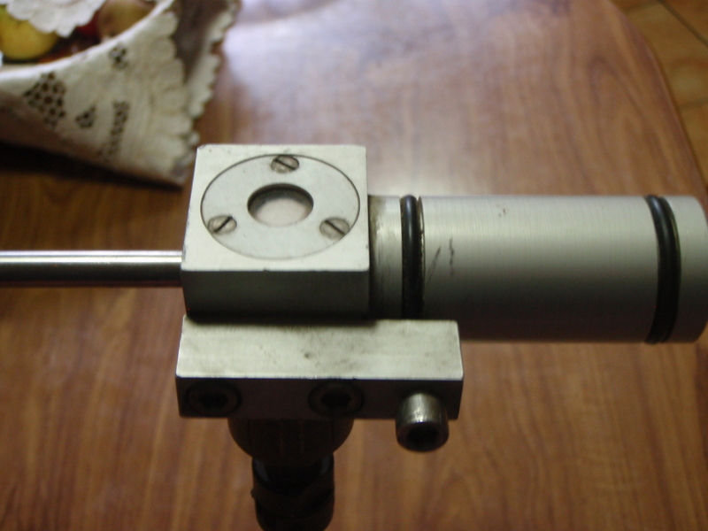

DRN-301;
Global Net Radiometer; 300-80,000nm
1.4mV/kW/m2
[attachment=484]

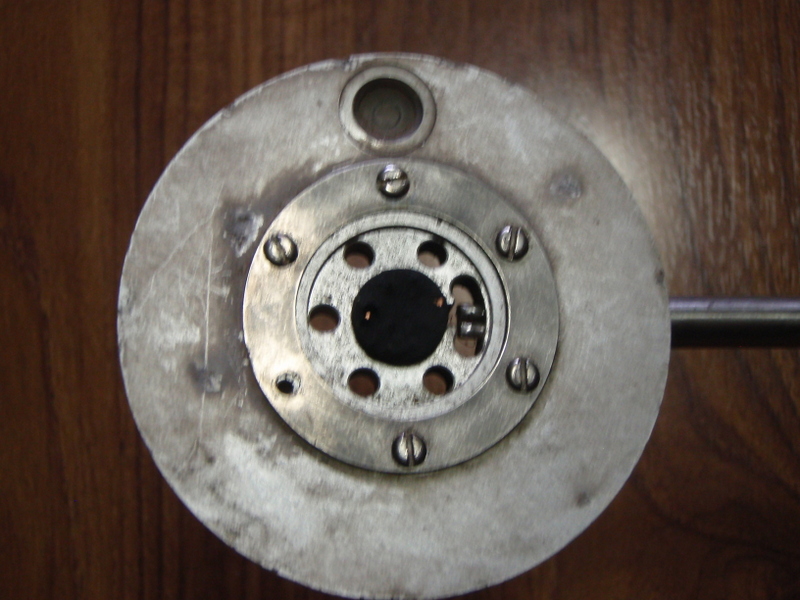

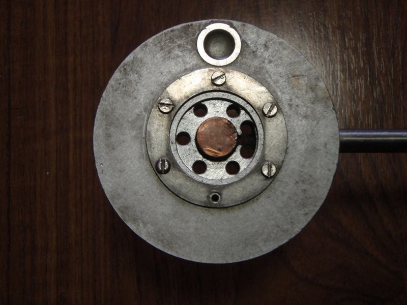

The DRN 301 has a thermopile; facing ground (bare copper side)
[attachment=481]
and facing sun (black coated side).
[attachment=482]
Presumably long wavelength for the ground to sense radiation emitted by soil, and Short wavelength for the sun.

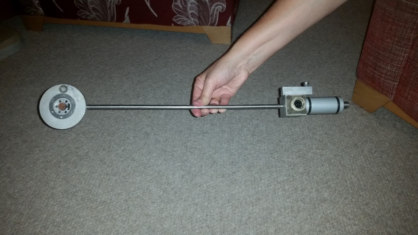

I think this used have a polythene "bubble" around either side of the thermopile which is kept inflated by a diaphragm pump
[attachment=480]
which pumps air through silica gel to dry it out to ensure bubble stays dry and clear.

The calibration certificate says that the solar sensor delivers 12.71 mV at 1000 watts/m2, which doesn't seem too far from the nominal specification of 14mV. I don't know what input level werk_ has used for the input calibration, but I see the "full scale" is (about) 1.1 volts and his maximum expected insolation is around 1400 Watts/m2. So I guess the required input level for 1000 W/m2 is about 700 mV. If you want to use the actual calibration of your sensor (assuming its calibration is still acurate after 15 years) then you will need to know (or be able to set) the exact value.
So basically you need to amplify the signal by about 700 / 12.71 , or around 55. If you are using a circuit as shown in post #52 here, then if the pot R3 is set to the top of its track (or better replaced by a 47k fixed resistor) then pot R4 needs to be set to about 850 ohms (takiing into account the 18 ohms source resistance). So a 1k or 2k2 pot might be better, or ideally an 820 ohm fixed resistor if you are able to use a calibration factor in the WeatherDuino software.

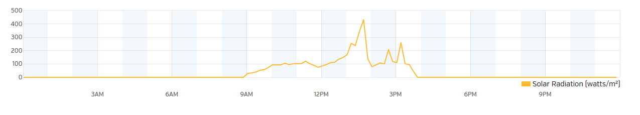

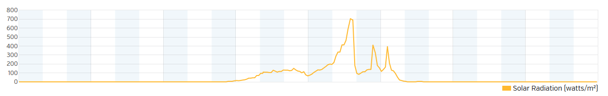

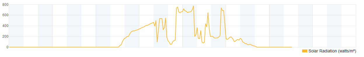

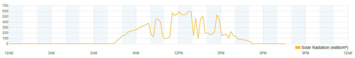

Showing the flexibility of Weatherduino. Graphs from yesterday showing the Didcot DRS-5 and Davis Solar readings from wunderground graphs. There is an offset between the two, which increases as the insolation increases from a few watts /m2 at the lower end of the range to nearly twice at the upper end.  I must check against another pyranometer to see if it is the 17 year old Davis which has been in use for nearly a decade, or the new old stock Didcot needing a slight tweek on the 2K potentiometer (or calibrate the software). The DRS-5 is attached to the solar / UV board using the resistors detailed by Allycat above. The Davis is working through a 17 year old Davis Groweather system. (IMAYBOLE2 is Weatherduino; IAYRSHIR8 is Davis). They are about 1m apart.
Sunny Scotland!!
Weatherduino:
[attachment=929]
https://www.wunderground.com/personal-we...210/mdaily
Davis Groweather:
[attachment=928]

The difference in the amplitude of the two "spikes" in the afternoon are noteable.  It's probably a "sampling" issue: generally Cumulus (and other software) just takes a "snapshot" reading at a particular instant after each logging interval.  That makes comparison very difficult for values that are changing from minute to minute, or even second to second.  Of course Cumulus can maintain a running average for wind speed, but not AFAIK for the Solar measurements.
For Solar calibration you really need a cloudless sky, not just a clear view of the sun, because light can be reflected off clouds and increase the apparent insolation.  So Calibration is a lot easier for those in Portugal or Australia than here in UK.  Sad
700 W/m2 seems too high for your location at this time of the year, if the sensor is horizontal.  The Cumulus "(Theoretical) Solar Max Rad" curve (select a graph) should give a fair indication during most of the day (I have some doubts about the level near sunrise/sunset at our latitudes).
Cheers,  Alan.
Thanks, 700w/m2 seemed high to me, I shall get a pyranometer we have at work and see how they compare. Nothing is calibrated though they are just used for teaching but if I get similar reading from it and the Groweather then at least I will have an idea we are near the mark. I just need that rare combination of time and good weather. A rare combination up here. I have acquired an Apogee pyranometer from a police ebay auction and shall try that when I get it up from Somerset at Easter.
