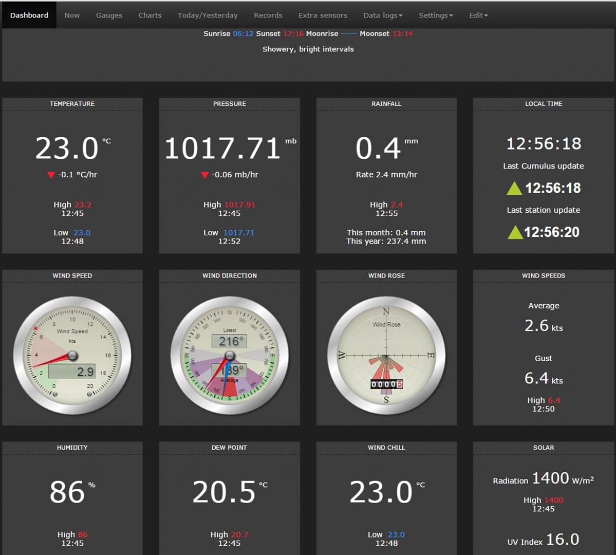

Success... I've got the CumulusMX software up and running on the RasPi3, and connected to the WeatherDuinoPro2 RX station. I'm using the built-in wireless adapter on the Pi3. Stats and data is coming through on the USB, and I've had the Cumulus website (on the Pi) open in a browser on one of my PCs for a couple of hrs now, and all good so far, and no lock ups. (Note that I don't have the solar sensors connected at this point in time, so those figures will look a little skewed (read: High) in the screenshot) I've been making heaps of notes and I'll do up a quick "how to" guide sometime soon.
Mark R
[attachment=658]
{click photo to enlarge}

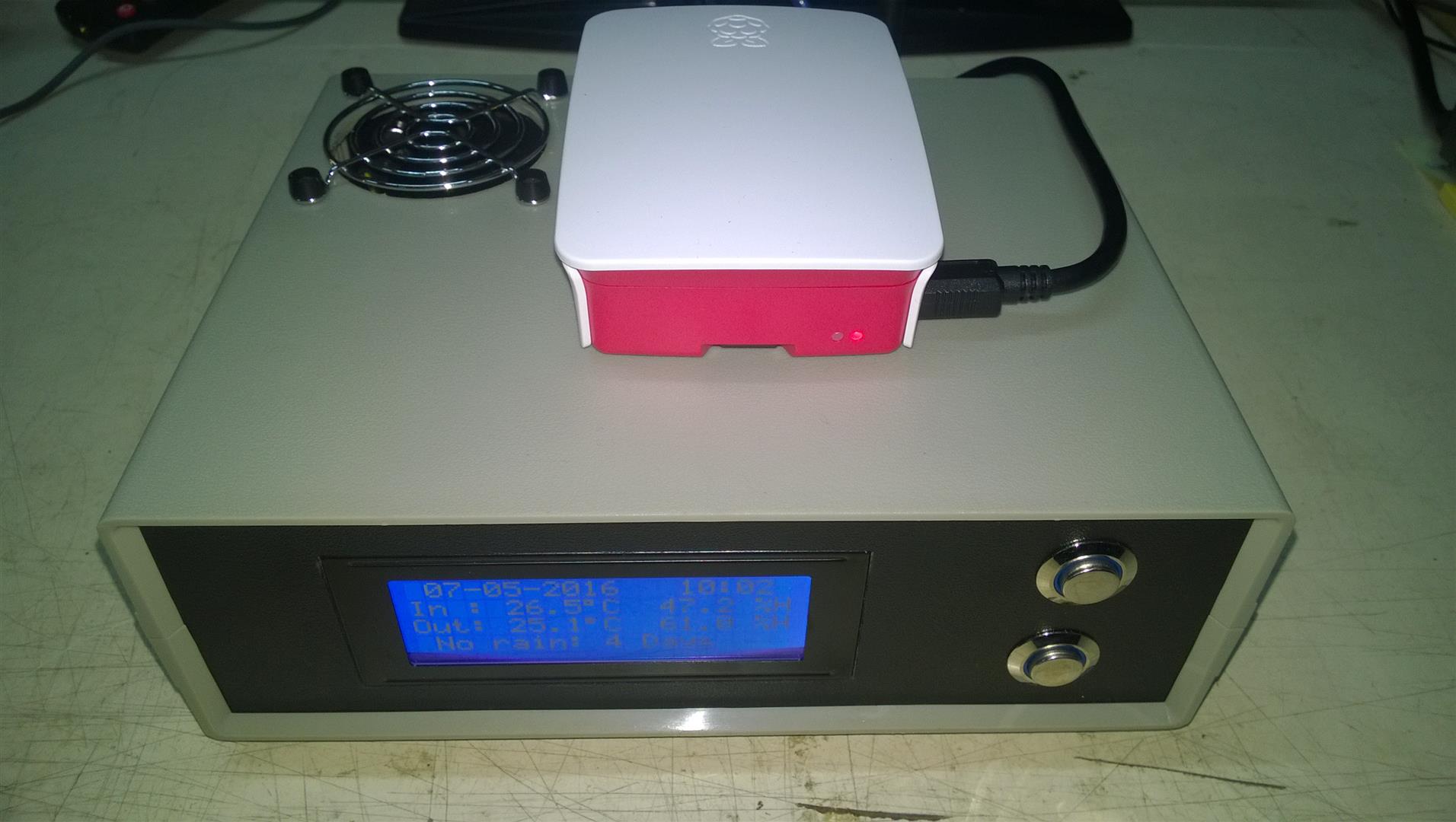

I too have a Pi3 running CumulusMX and uploading every few minutes to WeatherUnderground. Its a really nice solution. I installed a Voltage Buck Module in my RX station to reduce the voltage down to 5.1V and this runs my Pi3, with battery backup (inside the RX station). A true stand-alone RX and Upload solution.
[attachment=673]
Lets know how you get on re automating your timezone setup.
