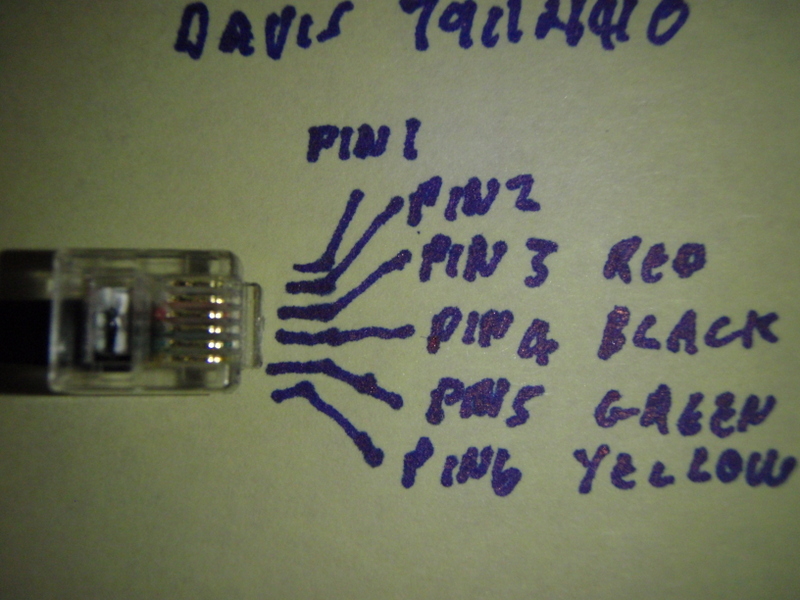

Notes For Fitting Davis Anemometer and Wind Vane 7911 & 6410 to TX V3.xx (and many other reed switch/potentiomemter makes and models)
This wiring also applies to any Wind Vane/anemometer combination with a potentiometer on the Vane and anemometer with a reed switch. For example, Didcot instruments with this combination and many others.
The 6410 and 7911 are identical in all respects except that there are two small 47ohm resistors either side of the reed switch on the 6410 and some later models of the 7911. The older 7911 had the red and black wires soldered directly to the reed switch. Both models will work with Weatherduino in the same way and require rewiring as below.
Also note that if you wish to try your own Davis instrument you will need to cut the RJ11 6P4C off and replace with an RJ12 6P6C (note RJ11 and RJ12 are identical Plugs with different numbers of pins ) On the replacement RJ12 use pins 3,4,5,and 6. Leave pins 1 & 2 empty.
[Image: attachment.php?aid=543]
[Image: attachment.php?aid=544]
[attachment=543]
[attachment=544]
TX v3.11 RJ12 pinout:
Red - Pin3 (GND, for anemometer and vane)
Black - Pin 4 (Anemometer)
Green - Pin 5 (Vane, from variable resistor)
Yellow - Pin 6 ( 5V, for vane)
