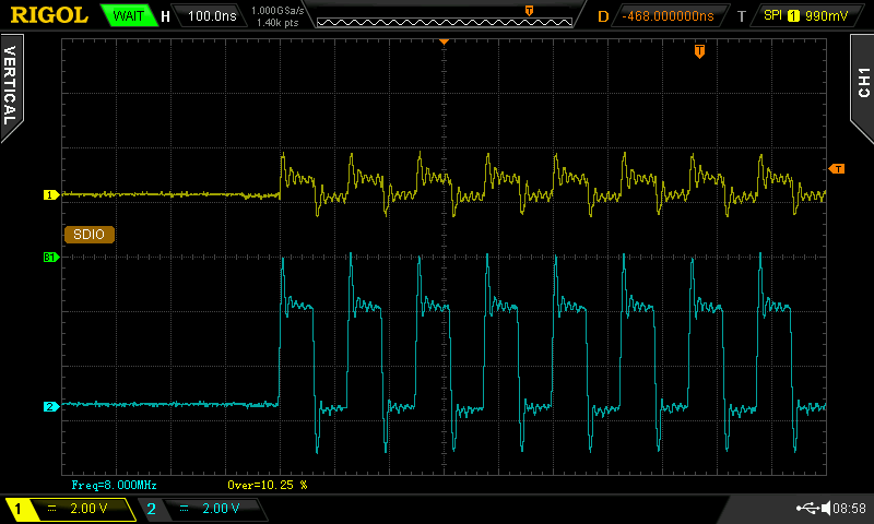

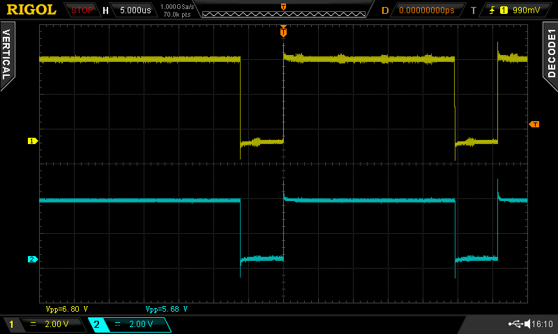

(15-08-2015, 21:22)danb35 Wrote: [ -> ]CS10, though, is showing much slower rise/fall, ...
This is normal as the CS10 signal doesn't pass through the logic level converter, attenuation is done only by a resistor.
There is something strange with the voltage levels. As the Arduino Nano is powered by only the USB 5V, and there is always a small voltage drop (0.7V) at the schottky diode, how could you get a Vpp of around 6.24V?
Despite the voltage readings (you should check that) the pics show that the logic level converter is doing its work.
I'm inclined to say that the problem is with the cables or even with the display.
What voltage do you get at the 3.3V pin? This is the reference voltage for the output of the logic level converter, and it will not be higher than that value.
The peak-to-peak voltage includes the over- and under-shoot, but the traces show the right at least approximate voltage (i.e., 2.5 divisions on ch1, 2 volts/div = 5 volts). I haven't yet dug through my scope's menus to see if there's a different measurement for peak-to-peak that would ignore the overshoot.

Quote:The peak-to-peak voltage includes the over- and under-shoot, but the traces show the right at least approximate voltage (i.e., 2.5 divisions on ch1, 2 volts/div = 5 volts). I haven't yet dug through my scope's menus to see if there's a different measurement for peak-to-peak that would ignore the overshoot.
I gave a more closer look at the images from your oscilloscope.
If you ignore the over- and under shoot, the signal voltage for Channel 1 is around 4.8 V (seems good), and for Channel 2 is around 3.3V (seems good).

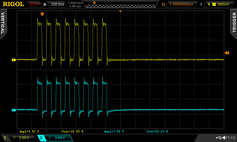

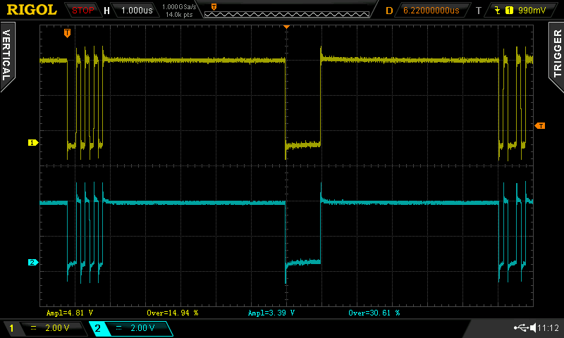

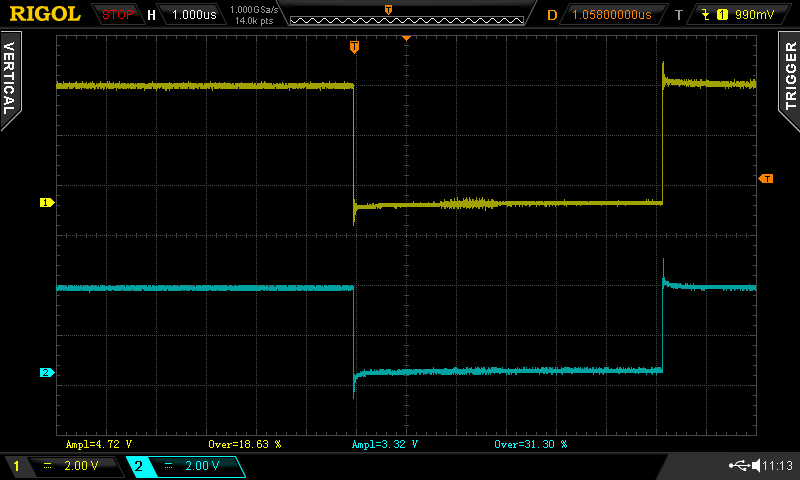

A few new scope traces, with more appropriate measurements.
MOSI:
[attachment=396]
SCK:
[attachment=397]
DC:
[attachment=398]
Observations: Amplitude measurements seem entirely reasonable. Overshoot on the 5V line ranges from 14.9% to 18.6% (0.7 to 0.87 volts). Overshoot on the 3.3V output ranges from 22.4% to 31.3% (0.80 to 1.03 volts). Overshoot is measuring only the low-to-high transition, not the high-to-low transition. Thus, overshoot is higher both in relative (percent of amplitude) and absolute (number of volts) terms on the output of the level shifter.
I'm not at all saying this is the problem--I don't know enough to suggest that. It just looks a bit anomalous to me.

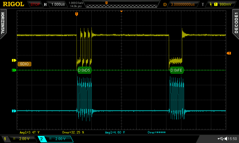

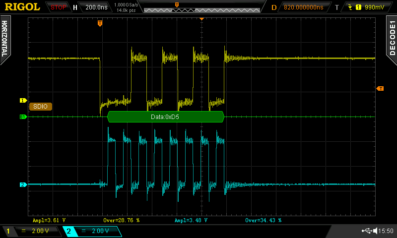

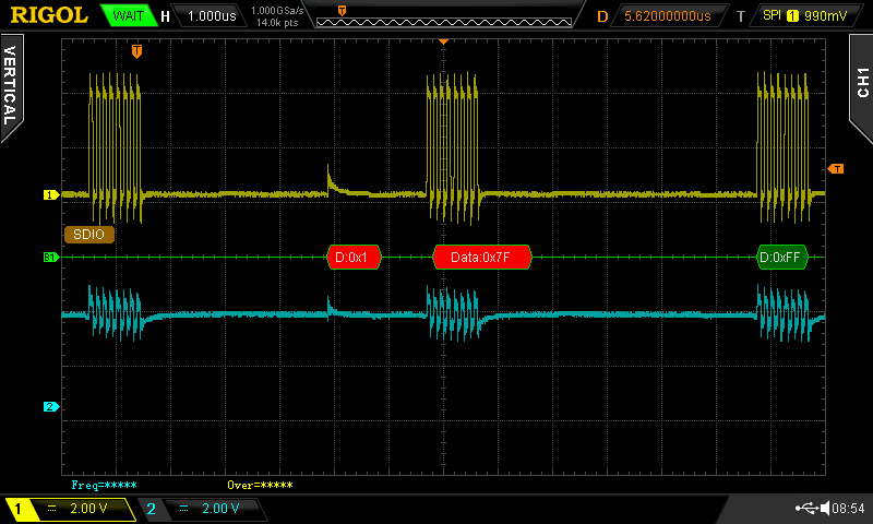

I've taken a couple of traces with MOSI and SCL showing--MOSI is in yellow, SCL in blue. Here they are:
[attachment=402]
[attachment=403]
