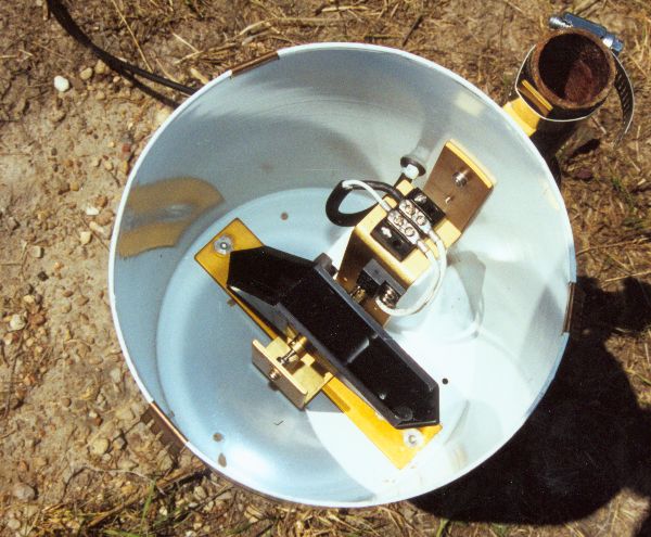

But if you want more accurate data consider an alternative such as Davis Rain Gauge or similar, remembering that each tip only on these better quality gauges represents 0.2mm (or 0.01" if it is an imperial gauge; NB: they are different and are setup differently mainly by the screw adjusters under each "Bucket" See attached) and one will need to alter the arduino sketch and / or the multipliers in Cumulus to get a correct rainfall figure. Davis or Texas Electronics ( and others are either calibrated as Metric or Imperial versions this is changed by altering the adjusting screws. Imperial gauges are calibrated to 0.01" or 0.254mm and metric to 0.2mm or 0.00787", as you can see there is a substantial 27% difference between the two and careful calibration is needed.

Most gauges which are of reasonable quality and accuracy ( Davis, (http://www.davisnet.com/product_document...852_SS.pdf) Texas Instruments who supply Hobo and others, and various other tipping bucket gauges), are manufactured using the same moulds and dimensions for both imperial and metric versions.
The gauges are then factory calibrated either metric or imperial versions by altering the adjusting screws under the buckets.( see pictures in post 22) They are then sent out as either imperial or metric version with an appropriate code or stamp. For example in the case Texas with either and “M” or an “I” in the model code, or with Davis 7852 a sticker inside the gauge stating the calibration 0.2mm or 0.01”
This calibration is described in the previous posts. (see posts 7, 14 & 22 in this thread). Though when done in a factory the accuracy is even better.

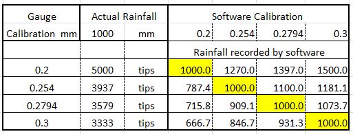

Let us consider a 1000mm / annum rainfall area ( approximately the annual rainfall in Ayrshire, West of Scotland.)
In a tipping bucket gauge calibrated to:
a) 0.2mm gauge this would take 5000 tips.
b) 0.254 (or 0.01”) gauge would take 3937 tips
c) 0.2794 ( or 0.011”) would take 3579 tips
d) 0.3mm gauge would take 3333 tips
If one had an imperial gauge and assumed it was metric and 1000 mm of rain fell it would only register 3937 tips but the software if it had been set as a metric 0.2 gauge would only register 787 mm of rain that year. A very large discrepancy of 26%.
Assume software is set to 0.2mm / tip and 1000 mm of rain fell.
i) 0.2mm gauge would correctly register 1000mm of rain that year after 5000 tips.
ii) 0.254 (or 0.01”) gauge would incorrectly register 787mm of rain that year after 3937 tips.
iii) 0.2794 ( or 0.011”) gauge would incorrectly register 716mm of rain that year after 3579 tips
iv) 0.3mm gauge would incorrectly register 666mm of rain that year after 3333 tips.
These are large discrepancies and would mean that any data generated would be of little value when gauge calibration does not agree with software input.
