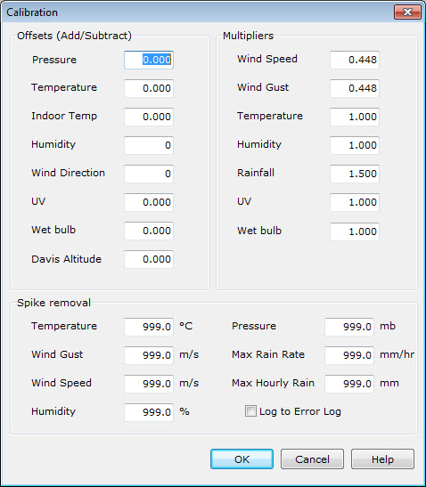

1. My rain bucket from Sparkfun says it tips every .0111 inch or .2794mm of rain. Is this amount the same as expected by the Fine Offset rain gauges and is the calibration multiplier setting in Cumulus of 1.500 correct.. Maybe mine is one, I don't know.
You can use that multiplier for you rain gauge.

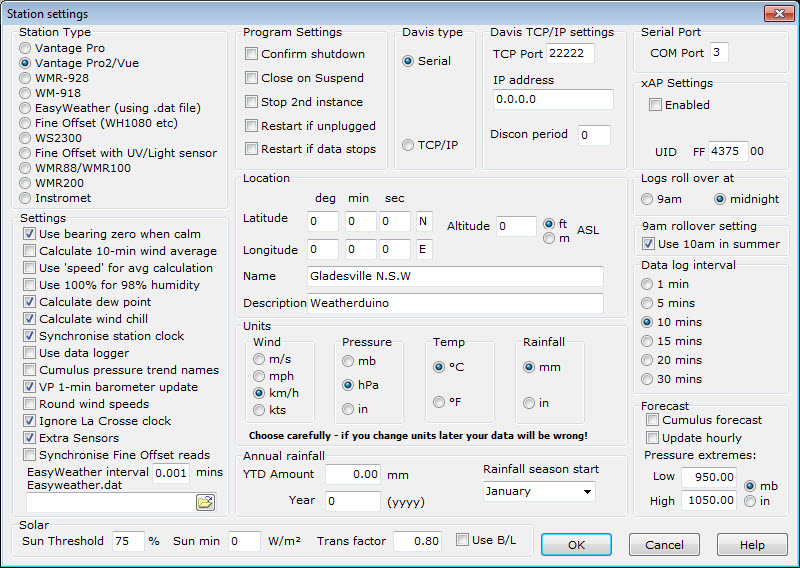

As for Cumulus the COM ports is OK, the Nano does not reset when I restart Cumulus as VP1 is on. After operating for some time(Hours) Cumulus error indicator starts flashing and I notice the Last Data Read time has stopped incrementing. I will try to add screenshots of the Cumulus settings but not confident I will get this right.
[attachment=199]
[attachment=200]
Everything seems fine with your Cumulus configuration (change logs roll over to 9am, as it is what is used in AU)
