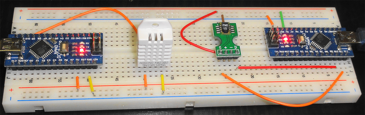

Today I placed one SHT15 and one DHT22 side by side, let them settle a while and then measured values read over 10 minutes in 2 second intervals and did some averages.
Under my room particular circumstances, results show the SHT reporting a difference compared to the DHT of approximately +3.8% in Humidity and +1,9% in temperature.
I understand many of you have done similar exercises, probably in a more reliable/detailed way and over more extended periods of time. Short of benchmarking the different chips under a controlled environment and against a perfectly accurate instrument, which is not easy, this is nevertheless an interesting exercise.
So, does anyone have more such comparisons to share? Perhaps even from running stations?
In the end, having the ability to compare, make up our own mind and hand-pick stuff is the beauty that makes a system such as WeatherDuino effectively far more powerful and interesting that any other pre-built weather station.
DHT22
Avg. Temp. (ºC): 14,95
Avg. Hum. (%): 62,27
STD Temp: 0,049924883
STD Hum.: 0,212347547
SHT15
Avg. Temp. (ºC): 15,24
Avg. Hum. (%): 64,63
STD Temp.: 0,06831321
STD Hum.: 0,272655715
DHT22 Values - SHT15 Values
Avg. Temp. (ºC): -0,29
Avg. Hum. (%): -2,36
