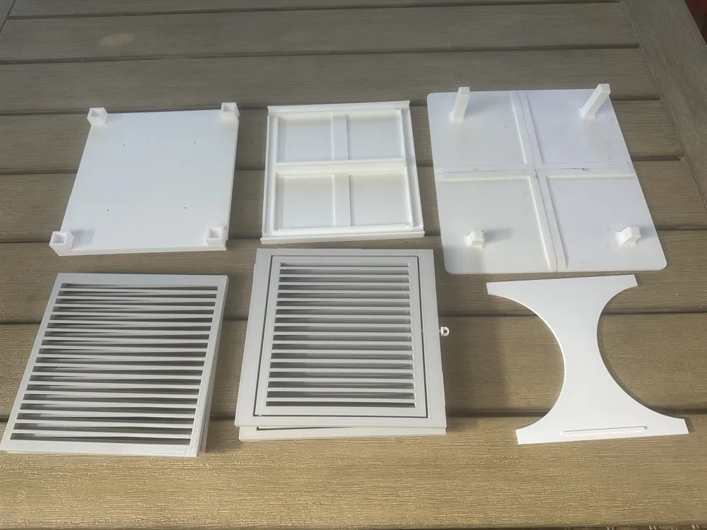

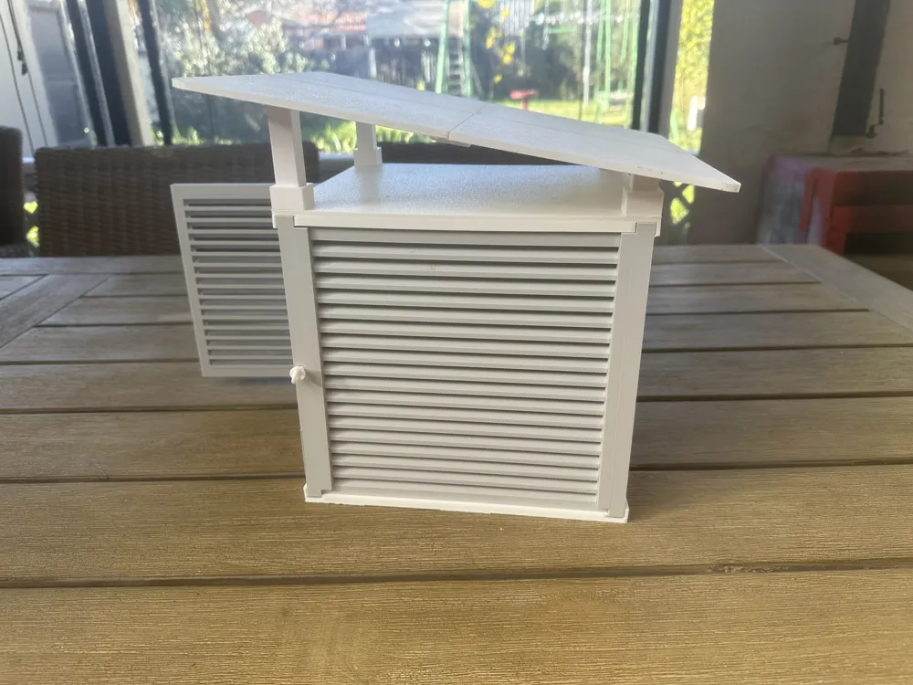

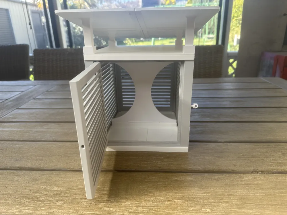

I couldn't find a Stevenson screen that looked like a real one, so I had a crack at designing on in Fusion. I'm still a novice designer but thought it turn out really well, especiallt the print in place door. Any feed back appreciated.

More images and the files at the above link.

It looks cool and functional, thank for sharing this design with us.

This design is genuinely well thought out, especially the easy sensor access without taking everything apart. For outdoor durability, printing in white ASA or PETG makes a lot more sense than PLA.
