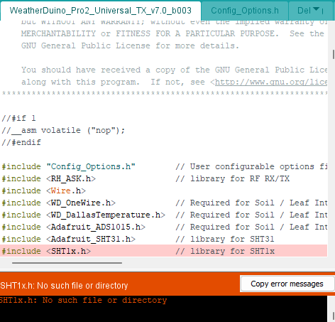

However, on trying to compile the TX software, I get a very obvious error of a missing library file for a temperature sensor.  Why is it just this one file, and how to I download it please?

Try Tools>Manage Libraries
then type SHT1x in the filter box on the right
should bring up the SHT1x sensor library and an install button
IanD
Thanks for the reply IanD, now I really should have been able to manage that one by myself. Blush For some reason, I had it in my head that the WD software downloads had all the extra drivers already included in them.
Edit: downloaded the only SHT1x library I could see, but that didn't sort the problem .... that library supplies 'SHT1x-ESP.h' not 'SHT1x.h.'

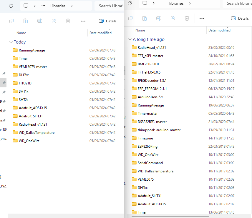

yes, it is indeed in the standalone TX folder, but I downloaded the Compact folder with both TX and RX software, and it is not present there. See below, TX libraries folder on the left, Compact libraries folder on the right.
[attachment=3260]
Anyhow, I now know where the missing library is. Smile
Ian
compiles fine now, thanks.  There were 3 libraries missing from the Compact libraries ... SHT1x, SHT2x and HTU21D.
Ian
Is good to know that you managed to compile the firmware.
The WeatherDuino Pro 2 Compact software package only includes the libraries for the main firmware (the Pro2 Compact receiver), however considering that que package also includes the TX firmware I agree that it could make sense include the libraries for the TX firmware. It's done!
