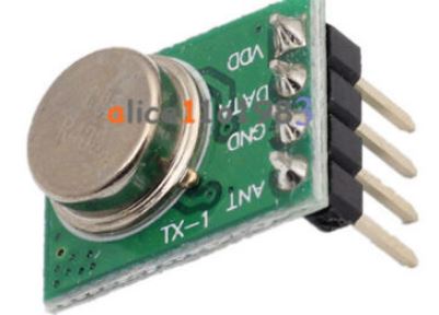

This is your old KXD-10036:
[attachment=3143]
The module you found:
[attachment=3145]
But H34C has different pinout (it is possible to use it, but you need to make some adjustments to the connector):
[attachment=3144]
