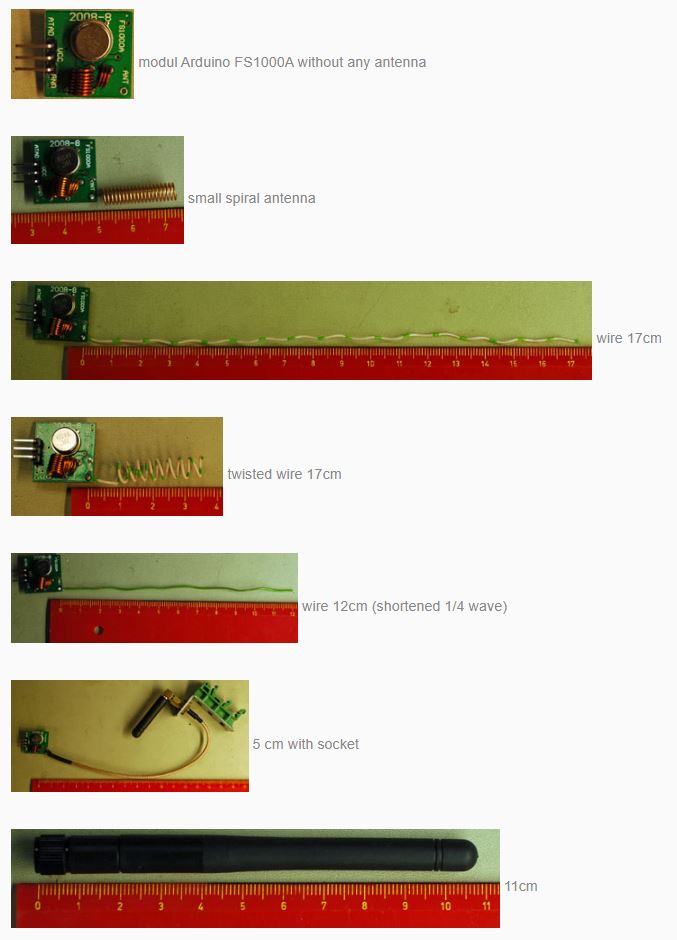

(29-03-2016, 13:54)hornychz Wrote: [ -> ][Image: DSC_6593-upr-sm.jpg] 20cm - unusable
[Image: DSC_6595-upr-sm.jpg] 1.5m - unusable
... the last two antennas are not applicable at all, even I bought them for 433MHz band!
Hi Zdenek
Thank you for your labor and time spent to elaborate this analysis. At least for me this matter is always complex. Smile
I have all types of antennas that you used in your tests, and your results seems to coincide to my practical observations, which leads me to make a question: As said, and just based on my practical observation, the last two types of antennas indeed proved to be very bad for transmission purposes, but for reception, are the ones from where I get better results... interesting I think.
If you have the time, could be interesting do the same tests but using the 20 cm long antenna in the receiver?

(29-03-2016, 19:18)Werk_AG Wrote: [ -> ]If you have the time, could be interesting do the same tests but using the 20 cm long antenna in the receiver?
Hi, Werk_AG,
yes, of course, it's a great idea!
I've used in my RX units 16 and 20 cm antennas. Now I've exchanged the both them for 5 cm and both RX units work perfectly on. But at this moment they are in the basement in my office. By default, the main RX unit is in the engine room and, unfortunately, almost touching the metallic copper pipes. And there I witnessed only by the 16 cm antenna, nothing else here does not work.
I'll prepare another test Smile

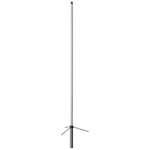

I came across one antenna which had very good reviews in difficult situations for numerous users, appearing on several fora and is not mentioned here so maybe other will benefit:
It from the well known company Aurel, they also make very good Tx and Rx receivers which I already use in my Domoticz domotica system.
This is the antenna: CLICK
Aurel GP 433 Ground Plane Antenna. cost is 36 euro's
Idea  someone on the Domoticz forum mounted it upside down on the top floor!
Any thoughts / experience with this kind of antenna?
This antenna is only suitable for vertical installation, which may be a problem as Werk_AG wrote yesterday in another thread
(TX on the roof and below it RX). On the other hand, it can be quite effective in field use. The basic problem: the datasheet
does not show the profit/loss of the entire assembly. And I'm afraid that the lineup will have a loss rather than a gain because
of the length of the cable. But without the manufacturer's data or measurements, it's just "divination from the ball". Positioning
upside down seems completely nonsensical - the antenna radiates minimally in its vertical axis. And the wire-simulated ground
should always be a ground not a ceiling.
But: I never used this antenna, so this information may not be guaranteed, it results from my experience. The antenna is very often
used to connect radio stations (HAM), eg in the 27 MHz, 134-174 MHz, 430-490 MHz band, ... But the transmission power used starts
at tens of W and ends at kW ...
