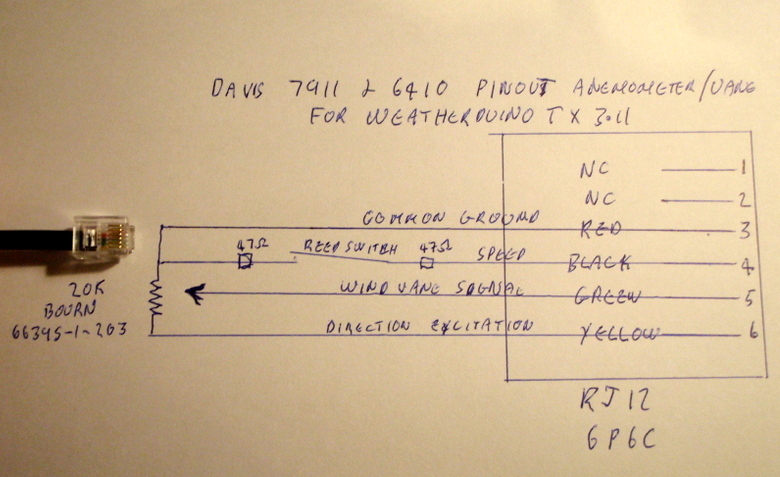

I purchased a new 7911 anemometer for an older Davis Weather Wizard III. The new anemometer has a RJ11 size plug and the old anemometer has a RJ45 size plug. Is there any way to make the new anemometer work?
werk_ag
01-02-2022, 20:02
Once you know the pinout of both of your anemometers you could replace the RJ11 connector of the new anemometer by an RJ45.
Hope pictures below will help you:
RJ45
[Image: attachment.php?aid=543]
RJ11
tobyportugal
03-02-2022, 22:30
http://www.aprsworld.com/wind2/documents/davis7911.php
http://www.patarnott.com/atms360/Arduino...erVane.pdf
