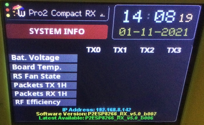

after the last update seem that the sw version and the latest sw available version are inverted with colors and positions too .
[attachment=2951]

Thanks for the report. The issue has due to an incorrect server response regarding latest software version, that is already fixed. So, after next latest software check your system will show the correct data.
