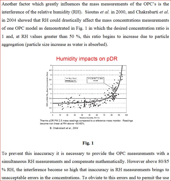

I don't know to which system you will connect your SDS011, nor the software it uses, however from the following document, things are clear.
MASS CALIBRATION AND RELATIVE HUMIDITY COMPENSATION REQUIREMENTS FOR OPTICAL PORTABLE PARTICULATE MATTER MONITORS
[attachment=2728]
Some DIY systems doesn't apply any correction on the software, that is why, specially on sensors installed in rural zones, you can see substantial changes on the readings along a day / night.
As in the case, observed on first post (regarding CO2 readings), without correction, the changes on the PM readings are in many cases caused by the natural changes of %RH along the day / night.

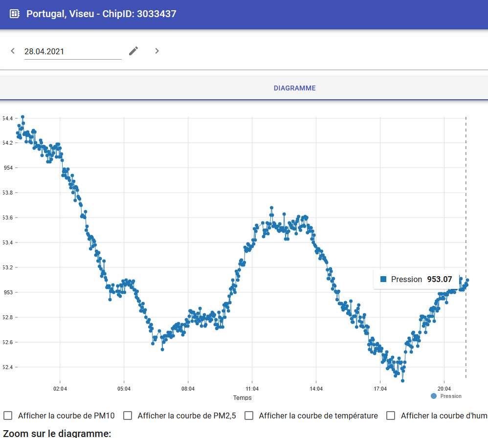

Toby, isn't a problem specific to a school in Viseu - Portugal. Hundreds of stations on that map, in several countries, report a pressure of 960mB, I think that happen because they don't have a pressure sensor installed (and it isn't required).
People are still learning on this field... is better be doing something than nothing.

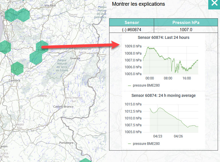

No Wink , there is a sensor that gives a correct measurement on sensor.community.
[Image: 2021-04-28_21-06-08.jpg]
I don't know why schools (Portuguese or other countries) want this application https://pm.chillibits.com/ which is a ....
[Image: 2021-04-28_21-07-52.jpg]
I know, I'm a pain in the ass... but high school kids going to see 960mb with a nice sunshine is making the youth stupid. (personal opinion)

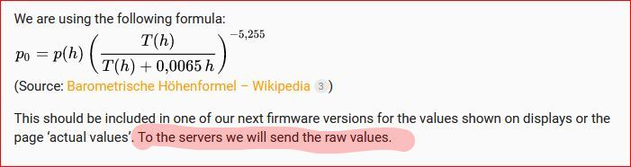

You don't know (nor I) if for their purposes, they are sending the Ambient Pressure instead of the Equivalent Sea Level Pressure. Maybe its better not be so critical...
By the way, what your sensors are sending for sensor.community is also Ambient Pressure, but what is show on their maps is the Equivalent Sea Level Pressure. Their servers do the calculation, they have the data needed for it!
[attachment=2729]
So, the "correct measurement" is also a question of what the purposes! We don't know the purposes of the "chillibits"
