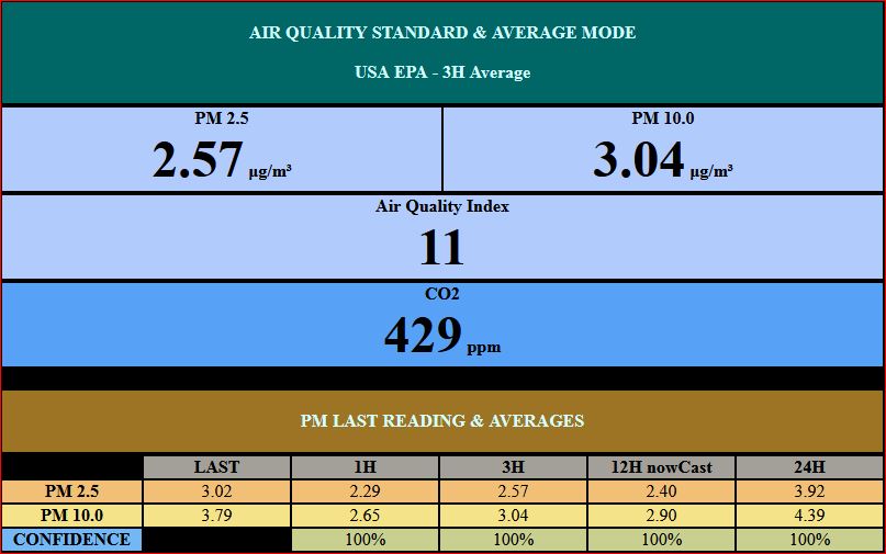

Unit 1
[attachment=2721]
Data measured with an WeatherDuino - Air Quality Monitor

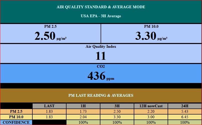

Unit 2
[attachment=2722]
