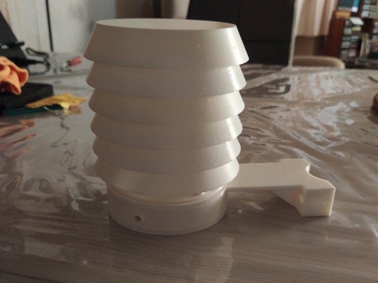

(14-06-2021, 18:08)laulau Wrote: [ -> ]Hi,
I've printed one in PLA for printer break-in  Big Grin
Mine is in PLA too. Then I painted it, after some months still look like new.
A 3D printer is an amazing tool.
