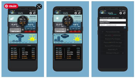

I have now (two days) the new app installed on my mobile, maybe it would be usefull for somebody else:
Tools4Monitoring
It is very simple, but very fast for Cumulus/CumulusMX web checking...
[attachment=2560]
