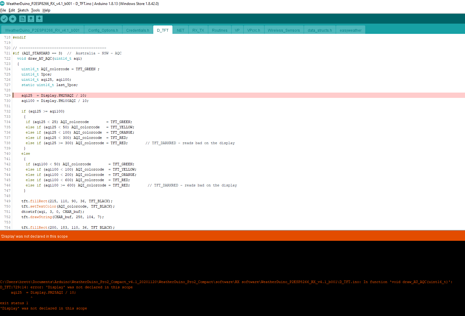

Version: P2ESP8266_RX_v4.1_b001
Getting a compile error whenever i set the AQI_Standard to 3. There is no problems compiling the code if AQI is set from 0 through to 2.
From Config_options.h
// If you have an WeatherDuino Air Quality Monitor the setting bellow MUST be defined
// The value of this setting MUST match the value defined on the Air Quality Monitor device
#define AQI_STANDARD 3 // 0= USA (AQI-EPA), 1= EUROPE (EAQI), 2= UK (DAQI), 3= AUSTRALIA (AQC - NSW)
Compile Log:
Arduino: 1.8.13 (Windows Store 1.8.42.0) (Windows 10), Board: "LOLIN(WEMOS) D1 R2 & mini, 80 MHz, Flash, Legacy (new can return nullptr), All SSL ciphers (most compatible), 4MB (FS:2MB OTA:~1019KB), v2 Lower Memory, Disabled, None, Only Sketch, 921600"
C:\Users\brett\Documents\Arduino\WeatherDuino_Pro2_Compact_v4.1_20201120\WeatherDuino_Pro2_Compact\software\RX software\WeatherDuino_P2ESP8266_RX_v4.1_b001\D_TFT.ino: In function 'void draw_AU_AQC(uint16_t)':
D_TFT:729:14: error: 'Display' was not declared in this scope
aqi25 = Display.PM25AQI / 10;
exit status 1
Thoughts?
[attachment=2554]
Brett
