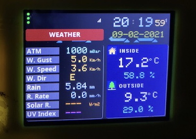

Hi, I’m been busy sorry , I will do that test for you as soon as possible, but for now I can tell you that last version works almost fine. I just noticed some weird things never happened before, about the visualization in the main screen . In the space which is the weather duino logo , sometimes it disappears and at his place seem a portion of the big clock , but I didn’t enabled it . Next time I will take a pic of the screen so you will see. To me it seem a screen refresh issue , like it try to use the big clock option but isn’t enabled. After a touch on the screen it restore to the correct image , everything go back normally .
Today I was checking online data on WU and it wasn’t online for unknown reasons , then I logged in on the WU portal and logged out again then it went online .
Everything else is ok to me. No more weirds temp values since the update .

Here you can see the logo missing and the clock digits image underneath the main page .
[attachment=2594]
Thanks for the picture. Now I need to investigate what causes this bad behaviour which I never have saw before.
If perchance you find the exact conditions which the issue arrives, or a way to reproduce it, that will help a lot.
Hi xxDvDxx,
Found the condition where the issue will happen, and its already fixed.
Despite it was easy to reproduce, hardly I ever would see it. Many thanks for having reported it.
Additionaly to the fix, on next release, the big clock only can be activated, auto or manually (by touching on the upper right side of the screen), after the receiver have passed the initialization sequence. So if someone sets the screen saver (the big clock) to per example 1 minute, the time only starts to count after the receiver have received data from the three main sensors (TWR).
I take the opportunity to say once again, that observing and even measure the time the receiver takes to complete the initialization sequence can give valuable information about the reliability of an installation. When using WeatherDuino transmitters, if that time is great than 1m30s (in good conditions it will be less than 40 seconds), the RF link should be improved, for Auriol users, more than 5 minutes also means difficulties in the RF link.
