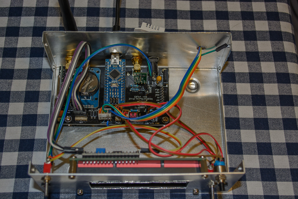

I had to do a little repair to my Receiver unit yesterday! A draw back using a metal case bit me yesterday morning as I casually walked up to it, and pressed the push button to light the screen. Being winter and dry I built up static and discharged into the housing. The LCD immediately scrambled, and the data relay light turned on solid. Powering down and up cured the display and readings, however the relay LED remained lit constantly. Turned out I blew transistor 2 in the process. I replaced it and all is good again.
So anyone else deciding to use a metal enclosure, beware! I now make sure I disperse my static build up before doing anything with my unit.
Since this meant a complete pull down of the box, I went further and disassembled the LCD so I could give the window another go with the file, results shown below. The curve in the line is where I was getting used to the nibbling tool, and overshot.
[attachment=335]
