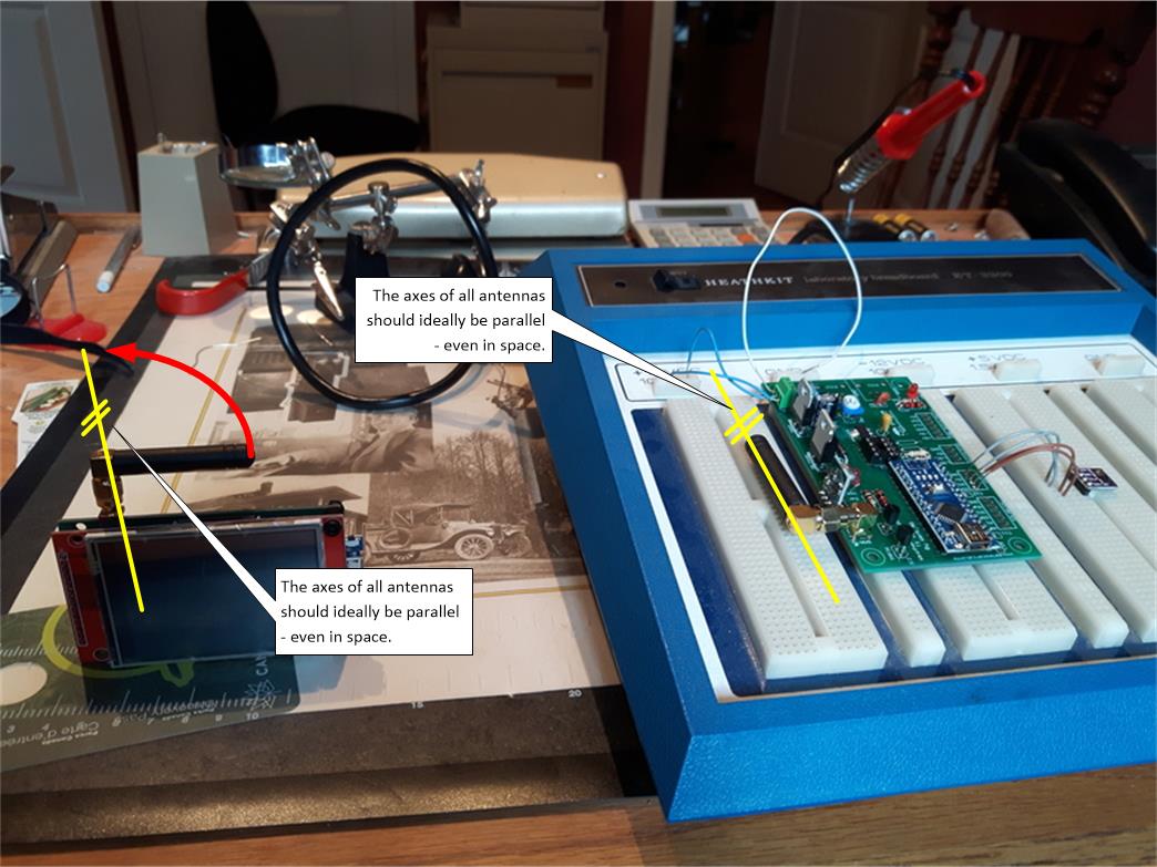

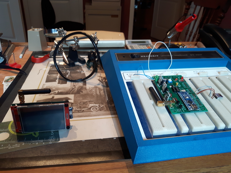

Thank you so much for the reply. I hope the following is what you need.
The antenna are from Ebay https://www.ebay.ca/itm/Antenna-433MHz-g...1a83b17c64
and I'll attach the photo you requested. The TX is not finished so please don't be too critical of my workmanship Blush
BTW, I used the wrong word in the subject, it's not reliability, I believe it's called efficiency.
[attachment=2290]
Hello Gord,
If you have this device so close together, they will probably work without antennas (not recommended, the transmitter may be destroyed). But as soon as you zoom out, you have to set the axes of all antennas as parallel as possible. The picture from you is the worst possible case, when the signal is almost completely attenuated. (Conversely, in such close proximity, if the antennas are correctly adjusted, the signal strength may be too congested, so this adjustment is acceptable and perhaps the only possible at such a small distance.)
[attachment=2291]
Please try and let me know if it helped. Good luck.
Hi Gord,
think the best would be in your case if the antennas are parallel to each other.
Also, the transmitter module on your TX could also be of bad quality - sometimes the carrier frequency is drifting.
But I do not think that is the case because everything is good if you are close.
And in the end, the antenna could be of bad quality. Mostly you can say the smaller the antenna the result does not get better.
I use self made dipole antennas and I get an efficiency over 80% over about 50meters and one wall.
