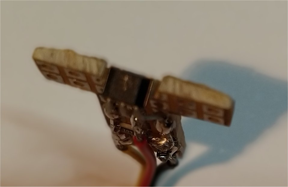

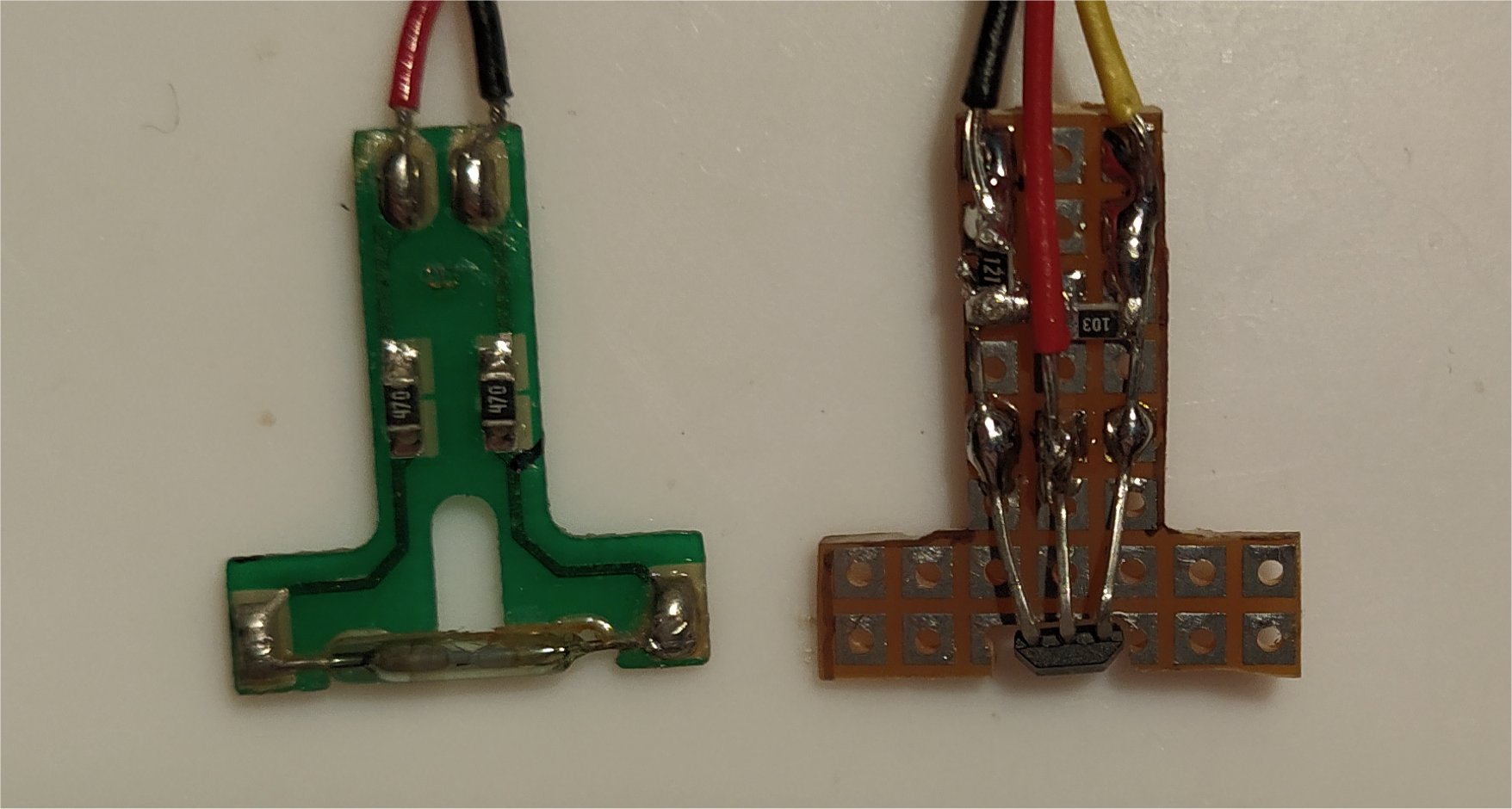

I gave it a try today withe a hall effect sensor.
it seems to work with the TX unit after bringing the magnet closer but didn' with the VP2 !
[attachment=2156]
[attachment=2155]
[attachment=2154]
Any suggestion ?
laulau Wrote:Hi,
Any suggestion ?

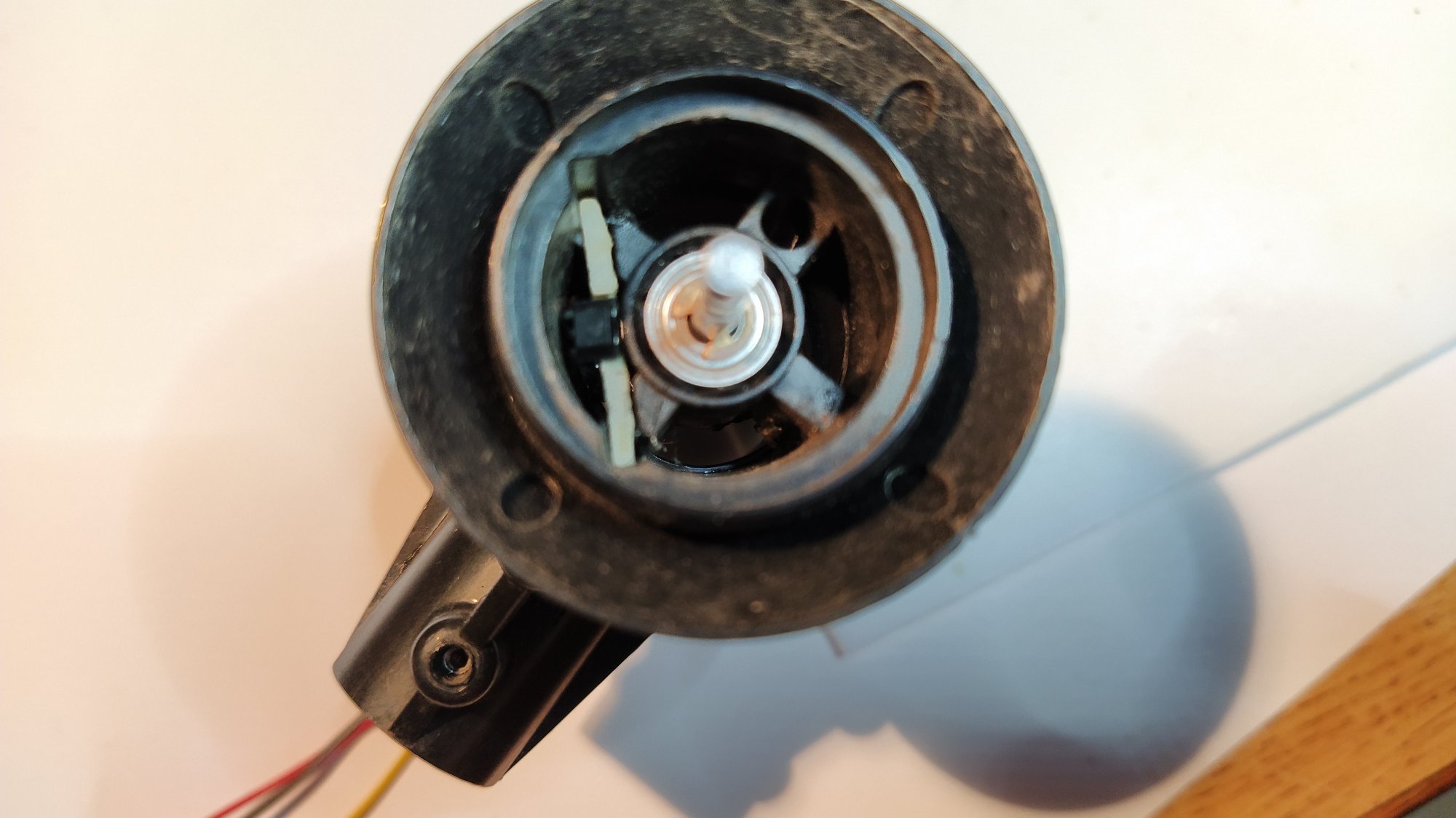

The magnet position was deeper inside the wincup originally, i pull it out like this :

Yes it works with WeatherDuino, i use a spare TX board with wind debug.
With the original VP2 it don't, i suspect a impedance problem.
I have a 10K pullup with a 120 ohm serial resistor; the signal is low (0.15V) when connected to the VP2 transmitter even without the magnet in front of the sensor.
According to the measurements I was able to make (with a voltmeter) the supply voltage supplied by the VP2 on the steering potentiometer is not constant: it is only present every 3s approximately. It cannot therefore be used to power the hall effect sensor.
This modification works in any case with a WearderDuino TX card which supplies 5V. Cool
I wonder how they do at Davis with their new anemometers with hall effect sensor which seem to be compatible with the older.
So unfortunately I have to replace a reed switch Angry because the anemometer that I am repairing is that of my Davis VP2.
(29-01-2020, 10:14)laulau Wrote: [ -> ]According to the measurements I was able to make (with a voltmeter) the supply voltage supplied by the VP2 on the steering potentiometer is not constant: it is only present every 3s approximately. It cannot therefore be used to power the hall effect sensor.
Sometimes the KISS* concept of WeatherDuino reveal its advantages. Smile
Not having been projected to be operated by small batteries, give us some facilities.
Indeed, the Davis ISS gives power to the sensors just for a very small period of time. Perhaps the hall effect sensor used doesn't work with the low voltage provided by Davis (not sure, but I think it is around 2.5 to 3V), other option may be trying to use a small supercap to keep the sensor always powered.
