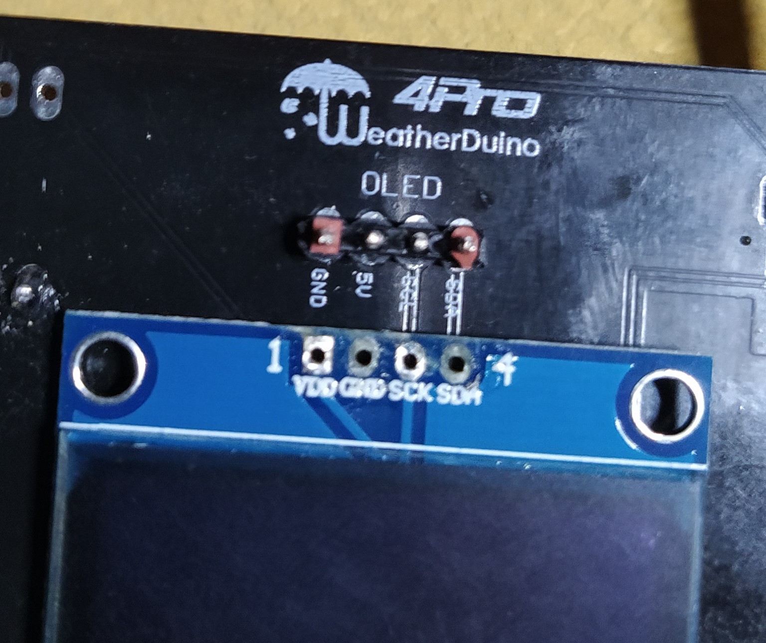

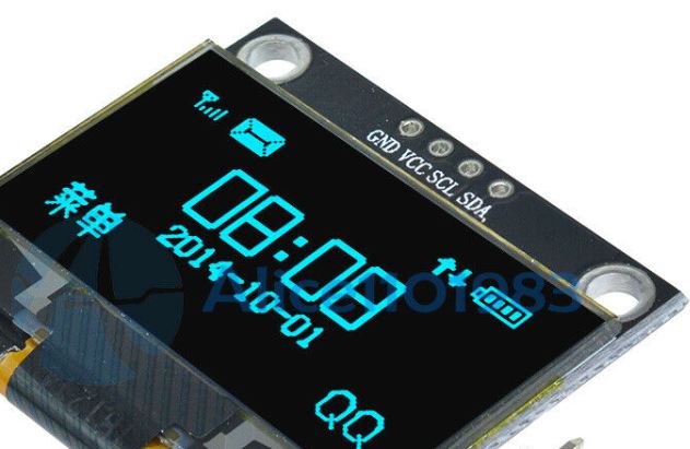

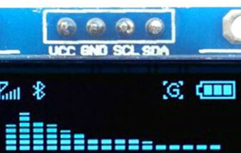

It seems that there is diiferent version of the 1.3 " OLED which does not have the interface pins in the same order!
[attachment=2128][attachment=2129]
Unfortunately I buy the wrong ones and solder without paying attention. When I wanted to program I realized it because I almost burned my finger! Angry
[attachment=2130]

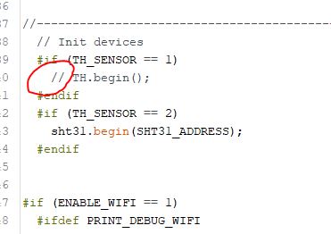

Nothing to do with the oled but my temperature sensor(HTU21) was not working because of that:
[attachment=2131]
Perhaps i don't have the last version ? (WeatherDuino_AQM_ESP8266_ASK_v200_b004)
(20-01-2020, 15:33)laulau Wrote: [ -> ]Hi,
Attention!!
Well, it looks like it has been a bit overtemperature at some point Angry
I don't remember where but I have read a reminder to be careful with the display pinning.
Do you know what is damaged? Only the display or the controller, too
Hi Laurent,
Those displays with a different pinout, even if connected by wires do not work with the AQM II.
Be careful when buying.

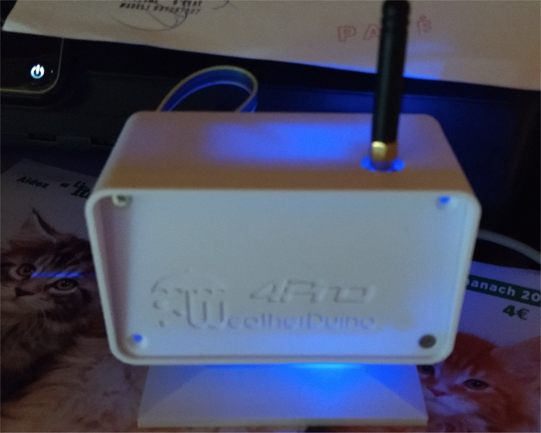

(20-01-2020, 18:13)engolling Wrote: [ -> ]....
 Don't worry the bord has resited and is brodcasting the datas to other displays! Wink
[attachment=2132]
(20-01-2020, 20:45)laulau Wrote: [ -> ]
Good.
Since you are using the "outdoor" version of the excellent Jarek case, you don't need the OLED display. The AQM II also works without the OLED display, just don't forget to disable it on the User_Config.h file
(20-01-2020, 21:20)Werk_AG Wrote: [ -> ]
Good.
That's what I did
It's the indoor version with the outdoor front panel ! Smile
