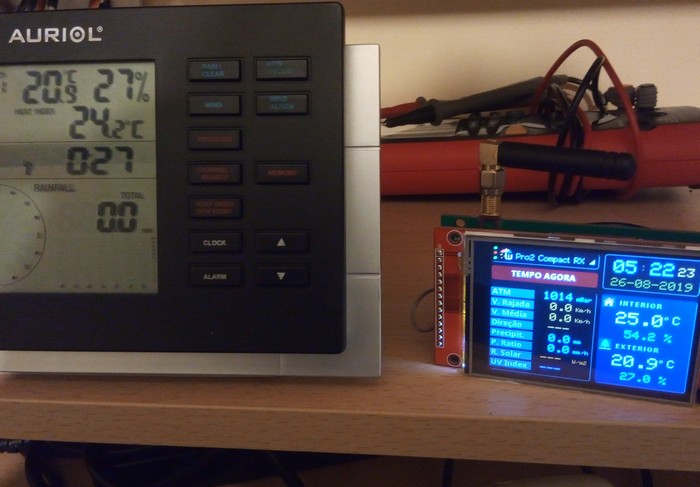

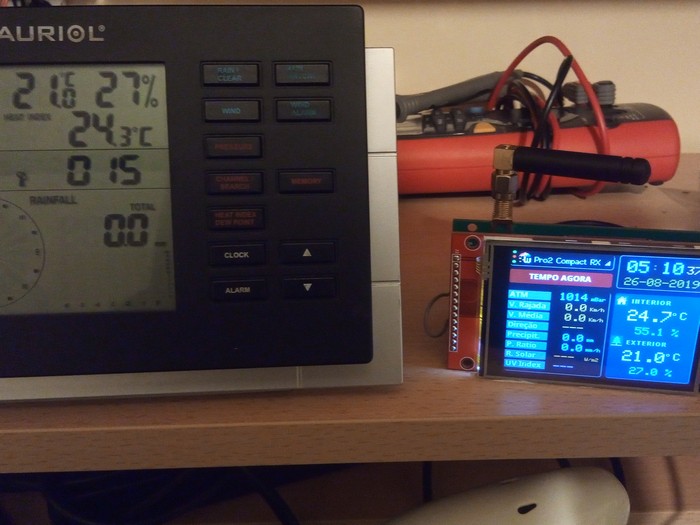

Temporarily I have reactivated my old Auriol weather station in an attempt to reproduce the reported behaviour, up to now I haven't see any problem with the temperature readings, both systems update almost at the same time, however I will continue monitoring the system to see if something wrong comes out.
[attachment=1938]
[attachment=1939]
Weatherduino only receives Temp / Hum data from channel 1, which is the default channel for the embedded T/H sensor on the Auriol transmitter unit, so most probably it will not get data from any other outdoor sensor. If you have any other indoor or outdoor 433MHz RF sensors, try temporarily disable them to check if this could be the cause of the corrupted T/H data.
