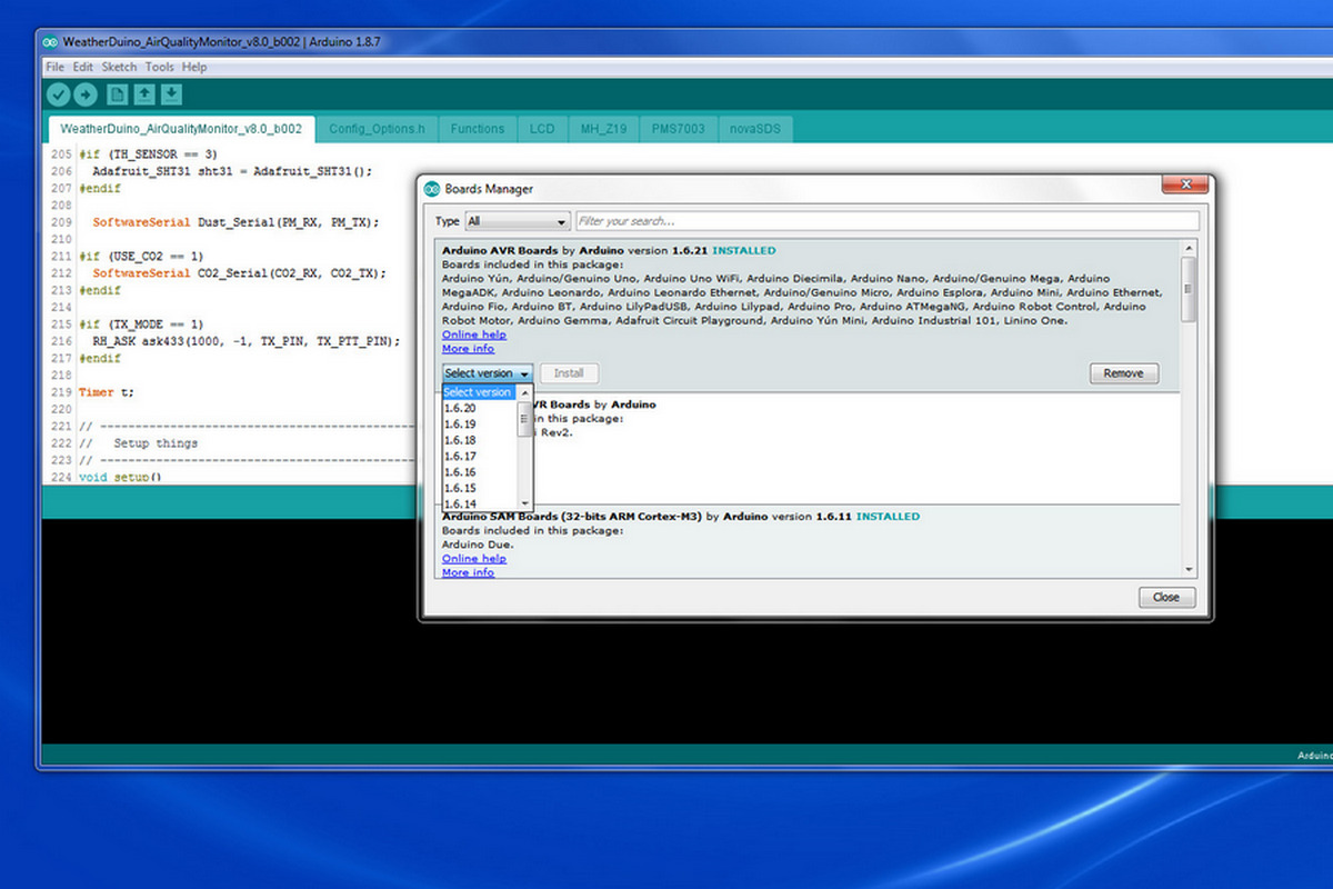

(02-11-2018, 18:40)engolling Wrote: [ -> ]... Arduino board 1.6.23 and guess what…
Smile Yesterday I installed IDE 1.8.7. With 1.8.4, 1.8.6 and 1.8.7 the latest AVR boards manager I can chose is 1.6.21
1.6.22 or 1.6.23 aren't available on the list.
By default 1.8.7 installed AVR board 1.6.21
For now I will continue using IDE 1.8.4. with AVR 1.6.21
That's strange, just that you know I'm not kidding. Wink

I know that AVR 1.8.23 exist, I just wondering why it isn't available on any of my IDE versions.
