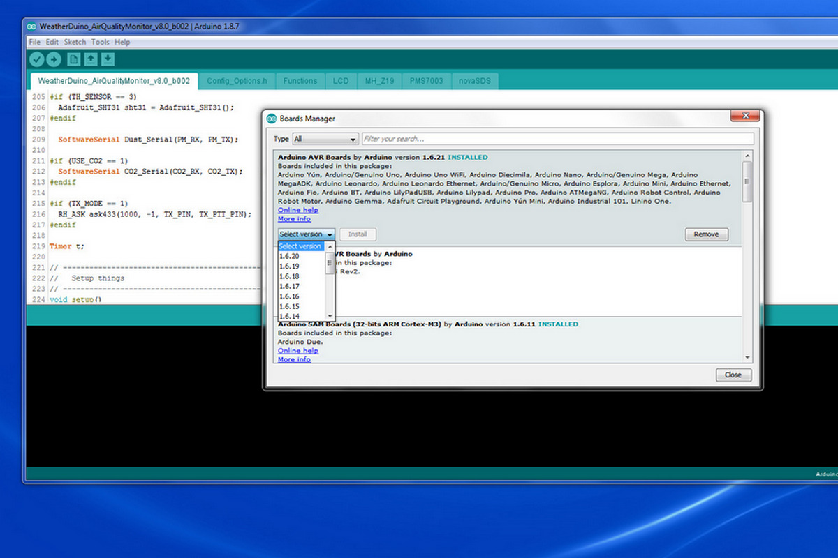

Yes, the RTC was being set wrongly. I will try to explain what I think about it below.

I think the culprit of this problem was myself and not the boards manager version. I was using a wrong method to adjust the RTC, which perhaps was work before, due to the forgiveness of the Arduino IDE compiler.
Adjusting the RTC clock using RTC.adjust(local), being the local variable a time_t variable is wrong. If you look at the RTClib, the function is expecting a DateTime object not a time_t var.
A DateTime is a full class with lots of methods to it, where time_t is just an unsigned long, used to store the number of seconds since the epoch (normally 01/01/1970)
The Arduino Time library returns a time_t to the now() function, but RTCLib (RTC.now() ) returns a DateTime object (and expect it at RTC.adjust(DateTime) .
I think this explains the problem.
The example sketch provided by RTClib works with both boards manager versions because it is well written. The argument passed to the rtc.adjust function is a DateTime object, not a time_t variable as I stupidly did.
