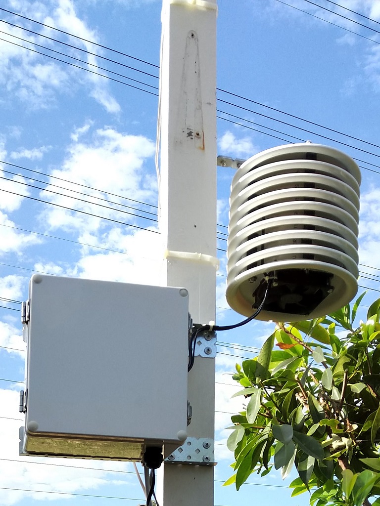

Hello everyone. I have commissioned my new and first SHT31, the one as shown in the link at the first post. I built a new radiation shield to house it in as I said I would. I am sorry I did not stop to take construction photographs and I should have.
I opened the casing and found that the sensor is very well wrapped in a membrane which is apparently permeable yet water resistant. The mesh arrangement is air permeable though I can see very little light through it. I was skeptical, however the response to temperature changes both up and down is almost instant, likewise humidity.
Shield consists of:
9 manufactured white pot plant saucers - 250mm.
90mm diameter PVC storm water pipe - 200mm long.
3 x 6mm stainless steel threaded rod stems.
Spacers between saucers.
Fan
All nuts and bolts stainless steel.
4 days solid work! I was on leave.
My previous shield, although worked well for a couple of years was nowhere near as robust. To make servicing easier I put plugs and sockets at the top, but out of the weather. The failure this time around was not the sensor as I expected; it was corrosion in the cable plugs! Regardless the rebuild was on the cards.
The sensor casing is inside the pipe halfway up. A hole in the side lets the cable out, and I made cable holes through the lower half plates to the bottom. Strain relief by cable ties, one at entry to the pipe back to one of the threaded rods. The other at the bottom to one of the fan bolts.
The SHT31 comes as illustrated, and its signal lead is 500mm in length. Slightly annoying and limiting where to put it and the transmitter, granted the length limitation for I2C, the cable could have been a little more generous. Because separable cables everywhere means more failure points, I was determined this time to eliminate them.
Thus my version 2.50 TX is up the mast now in the PVC box, I changed the connector headers to PCB screw headers and the sensor is hardwired with no joints. The fan has received the same treatment; I soldered an extension close to the motor and used heat shrink.
If I need to maintain anything, I have found it is no effort getting my mast down and up. I can reach the transmitter with a three step ladder, so I can still easily pull the Nano out for programming.
It has been online roughly two weeks, and is inline with nearby stations. The official station about 5km away I read typically up to 2 degrees higher, which I consider very reasonable. Overnight lows seem to be about 1 degree lower. I hope this SHT31 will last! It should be very well protected from the elements.
