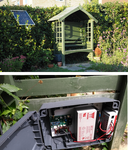

![[Image: busshelter.png]](https://ejmilton.uk/wp-content/uploads/2018/09/busshelter.png)
The first transmitter receives data from wind speed and direction sensors fixed above the ridge of the house, and temperature and humidity data from a modified Fine Offset radiation shield located in a shaded yard below. The transmitter in the garden has a wired connection to a solar/UV sensor mounted on a fence at the bottom of the garden.
A WeatherDuino Air Quality sensor mounted within the roof of the garden seat completes the set-up.
![[Image: P9170695.png]](https://ejmilton.uk/wp-content/uploads/2018/09/P9170695.png)
The whole system is powered by two sealed lead acid batteries, one in the utility room for the receiver and the first transmitter, and one in the garden for the irradiance sensors and air quality monitor. The batteries are charged from a 50 watt solar panel.

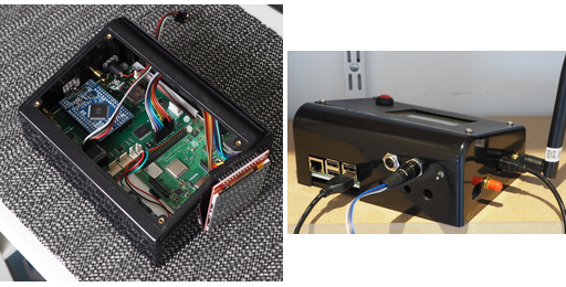

3. The sloping ABS boxes I used for my receivers (Pro 2 and Pro 2+) were the perfect size for a Rx board and a Raspberry Pi. They came from the Camden Boss Euro Desk 8000 Series [Part number BIM8005-BLK/PG].
4. I searched high and low for good quality splashproof connectors that were not too expensive and were neat, but easy to solder. I eventually settled on the Rean Mini XLR range and used these for the connectors for external T/H sensors etc.
![[Image: RxPro2.png]](https://ejmilton.uk/wp-content/uploads/2018/09/RxPro2.png)
