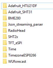

Hello ok2arm,
Something is wrong ... The only libraries, you need, are (by my opinion) in the package with software:
[attachment=1576]
Did you correctly choose the type of processor?

Hi Zdenek,
yes, all is set ok, procesor type LOLIN D1 R2 and mini, I have also library as is see in your pic...
And also have problem with RX compile..
